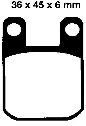

I have replaced pads on Motor Trikes before and this is what I used. EBC FA115 (4-sets)
