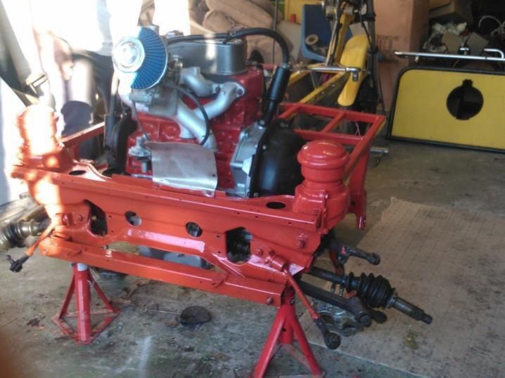

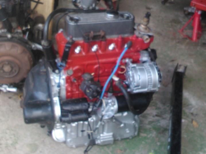

Don't have any of the finished trike but here are some work in progress.
Engine in the subframe
Engine out
