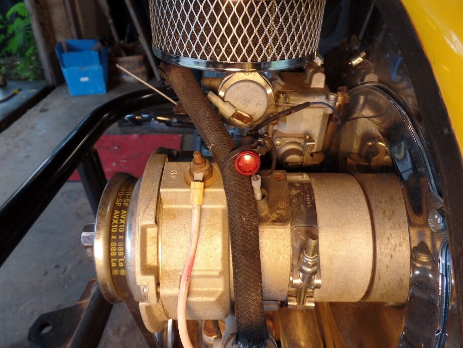

Okay, I'm going to try to post a couple of pics along with this info off the carb:
34PICT-3
Bocar
Hecho en Mexico
113 129 021P (on a metal tag attached under a screw)
Any ideas?

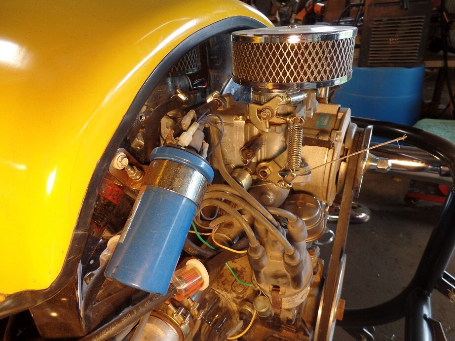

View attachment 47600View attachment 47601
Shot in the dark here, Bottom of the carb, [Bottom picture] . Now I'm just going by memories from when i played with VW's...70 to 75..Theres a silver colored round cylinder with a wire going to it, That wire is hot with the ignition on, It operates a plunger that if it loses power will shut the carb off....I would check that part/wire... That drove me nuts on my 71 beetle....Like i said just a shot here... :Shrug::Shrug:
Yes there is a wire from the distributor to that solenoid on the carb, not sure what function it has, it seems to be solid but I will check it for sure with a meter. Here's a zoomed out picture with the distributor.
The carburetor solenoid switch stops gas from entering the idle circuit of the carburetor when the key is off, or when it fails.
With it disconnected or when it fails, the engine will still run but only at speeds above idle. It won't idle at anything close to "normal" if/when it fails or comes unconnected from its power supply, (typically from the + side of the coil).
Not 100% recommended but it can be bypassed once it fails, by removing from the carb & cutting the plunger end off with diagonal cutting pliers or similar tool & carefully reinstalling it back in its place in the carb. I emphasize careful on installation as the carb body is aluminum or other such soft metal, & the switch threads are steel & can easily strip out the carb threads if overtightened or cross threaded.
Personally, I'd only bypass this "safety" switch if I was on the road.
The switch makes a noticeable audio "click" when energized, & can also be tested quickly by disconnecting the only wire running it & trying to start the engine in the "idle" position.
If it started easily before & won't start unless using heavy throttle after disconnected, the solenoid is bad.
Distributor doesn't look to have a vacuum advance. Probably a "009" mechanical advance only type. This dist / carb combination can be a bit quirky as I remember. Try some Internet research on this issue. I can't remember but it seems that there are some "non-stock" advance set ups that will fix or minimize this issue. Back in my shadetree dune buggy days we would just feather through the flat spot and put our foot in it to go but that was off road. "Drive it like you stole it" doesn't always work so well on the street!
Another "roadside" fix for the defective fuel cutoff solenoid was to unscrew it just enough to let the engine idle (usually about 1 1/2 turns) and leave the wire connected. The wire connected would keep the solenoid from vibrating out as you drive. I never had one leak or pose a problem.
