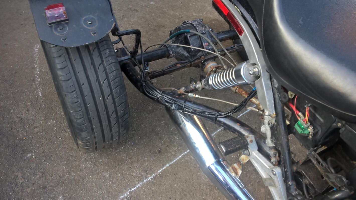

I'm sure there are things I've forgotten to mention but i think that's most of it. Basically, it handles like a potato and i'm not sure why. Any help would be appreciated :) WP_20180227_10_38_07_Pro.jpgWP_20180227_10_38_14_Pro.jpg
Sounds like shocks and springs would be a good start. Also, you might play around with the rear tire pressure see if lowering it helps. There's almost no weight on the rear.
Welcome to the Gang from Western Colorado.

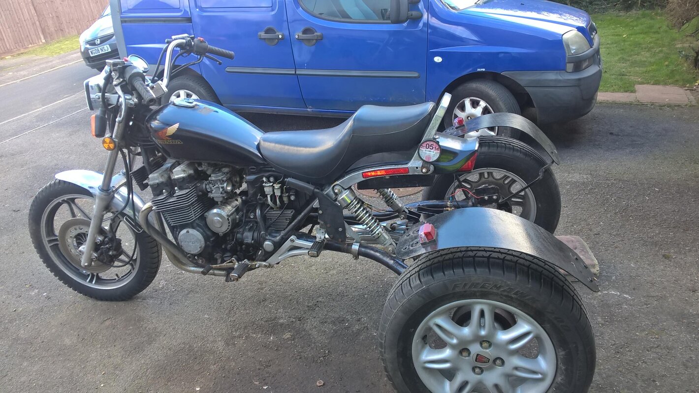

I'd try the rear tire pressure. From the pic, it looks like the tires are riding pretty high. Most trikes usually have 22~24 lbs in the rear.

After viewing the pix, I would run 18 - 20 psi in the rear tires. Start the suspension on soft and work your way up one notch at a time to improve the ride.

Looking @ the photo I see the rear shocks @ a pretty severe angle
The rear ride height is TOO high, that throws the front fork out of whack causing hard to steer and high speed wobble
IMO get the rear end down, move the shocks closer to the wheels if you can
Lowering the back should give you better steering and less wobble

I agree!
Move the shocks from under your butt to under the passenger seat, the rear is much to high.
Please fix it before taking it out on the road.

Edit: A quick google says I should aim for 15 - 20 degrees, I think mine are closer to 45.
Thanks again guys. Is that change the angle of the shocks or just move them further back? (Maybe both?) There's a bar going across further back i should be able to reinforce and weld some mounts for the shock, then just try and attach the top end further up by the sides of the grab rail.
Moving the shocks back will set them at a better angle in affect lowering the back end
However you may have TOO long of shocks also
Too long will keep your rear ride height to high, you want to drop it down to let the front end take control whilst you ride ( may have to get shorter shocks eye to eye and different springs)
I hope this helps and makes sense

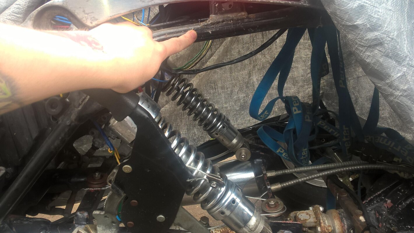

So, I've just opened up the back a lil and there's a nice bit of chassis i can drill a hole and weld a new mounting point for the shock. I've also had a look online and there's a host of shorter shocks i can fit for a reasonable price. I was just wondering how much you'd recon i should lower the shocks by. I think the stock ones on there are 340mm (Currently compressed to 310mm but i think they're knackered) and the shortest I've found so far are 280 mm. Before i buy any i'll retry my current shocks w/ the new mounting points and see how much that lowers the back end and how much it affects the heavy steering (A bit of rough trig says the back end should drop by about 20 mm).
Look @ mounting your shocks @ the sissy bar bolt, that looks to be a pretty good angle
Try a level on your seat, I bet it is WAY off, if you can drop the rear of the trike so the bubble shows level from what I see in the picture you could get a pretty close idea of your rear shock height JMO
