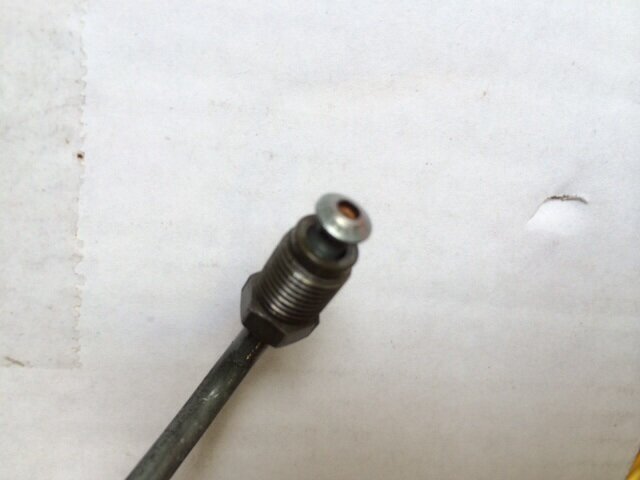

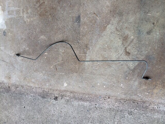

My brake line has a crack in it. The part is pictured below. It's a Champion kit for a VTX 1800. The bike is a 2004; the kit was put on a few years later. I see three choices here: 1. Build a new part. 2. Buy an OEM from Champion. 3. Buy whatever the equivalent car part is. Any information or experience anyone has with this issue would be appreciated.

Thats a bubble flare and most likely metric.Used on asian cars and trucks.A good auto parts store will have it.
Purchasing the parts and tool to bend the line will run around $30.00 total. Not too bad. I will call Champion tomorrow and see what an OEM part costs, and then decide what to do. Was hoping there was an equivalent car part already made, but it seems not. So my choices are narrowed to two!
Auto part stores stock straight tubes. Someone with tube benders (and experience) will cut off one flared end, bend the new tube to look like your old tube, then fashion a new flare at the correct length. Besides the length, you have to tell the parts store counterman the correct flare connector fitting size and threads (take the old one with you.)
If Champion will sell you a pre-bent tube + shipping, you'll have to compare it to the cost of a straight tube, and labor to have it bent and flared "in the field."
You still have to pay to have someone install the finished tube, and bleed the brake lines.

Cobbling brake lines together isn't the best way to go ~ it MAY leak later (either fluid out, or will allow air in.) Also, a brake flaring tool has to have double-flare capacity, which is more expensive than an ordinary single-flare tool. Since your counterperson doesn't have a long-enough length, Champion is your best solution. If it's pre-formed, and pre-flared, all the better.
At your experience level, if you're going to bend-your-own brake line, work slowly and use large radius bends at first. If you kink it, you'll have start over with a new one.:AGGHH: The sharp bend at the right side of your photo looks tough to reproduce. Maybe Cavie had a better idea ~ someone with experience who could bend and double-flare the line IF Champion doesn't have the one you need.

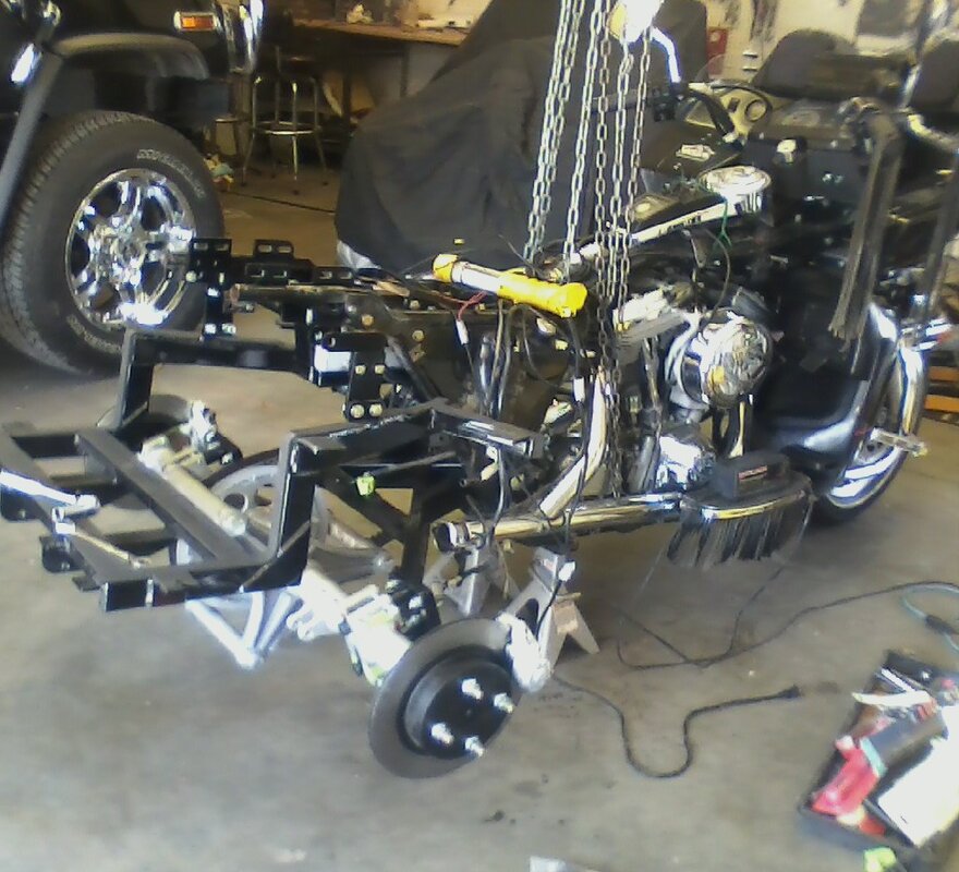

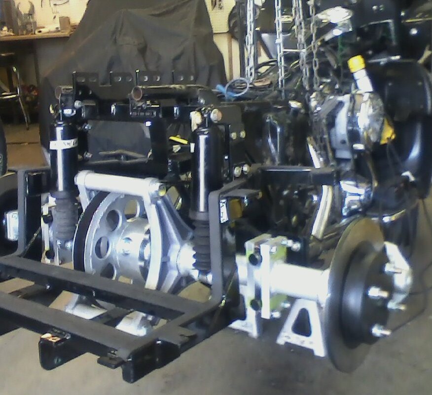

Heck if it was me I would unplug a few wires and drop the six body mounting bolts and take the whole back end out of way old son and as long as I had it down I would check alignment, torque values, wiring clips and find out what cracked your line to begin with?
This type of work isn't nearly as scary as it sounds. Download an instruction manual from Champion, open your shop manual and enjoy yourself!
d-3-bodyframeattached_zps311bcf5f.jpgd-11-readytomoveontobrakelines_zpsc11be625.jpge-13-readyfortheroadtest_zps0ecbaa3a.jpg

I think Cavie's (esp. comment# 2) had a good suggestion ~ "Any good independent mechanic can make one..." but it's not about the costs. Instead, you've unwittingly fallen into the "Do-It-Yourself" project trap. You can't just drive the trike to a shop and say "Fix this please."
I don't think the parts counterperson was helpful ~ it's not good advice to cobble a couple of shorter brake lines together. Instead, you need to approach an independent mechanic, and ask for help. The mechanic should be able to find a long-enough steel brake line, and the experience & tools to bend it and double-flare it.

Agreed.One problem she has is its not an inverted flare but a bubble.I haven't seen many with a tool to do those.We have a selection of various lengths at the parts store I work at.We also have fittings to change the bubble to allow use of a standard inverted flare.Using compression fittings and reusing the end sections of the old line is not an adviseable method.Not that it hasn't been done but safety becomes a serious concern.Polyarmor is much easier to work with than the plain steel lines we've been selling them for 5 yrs or better with no problems.
