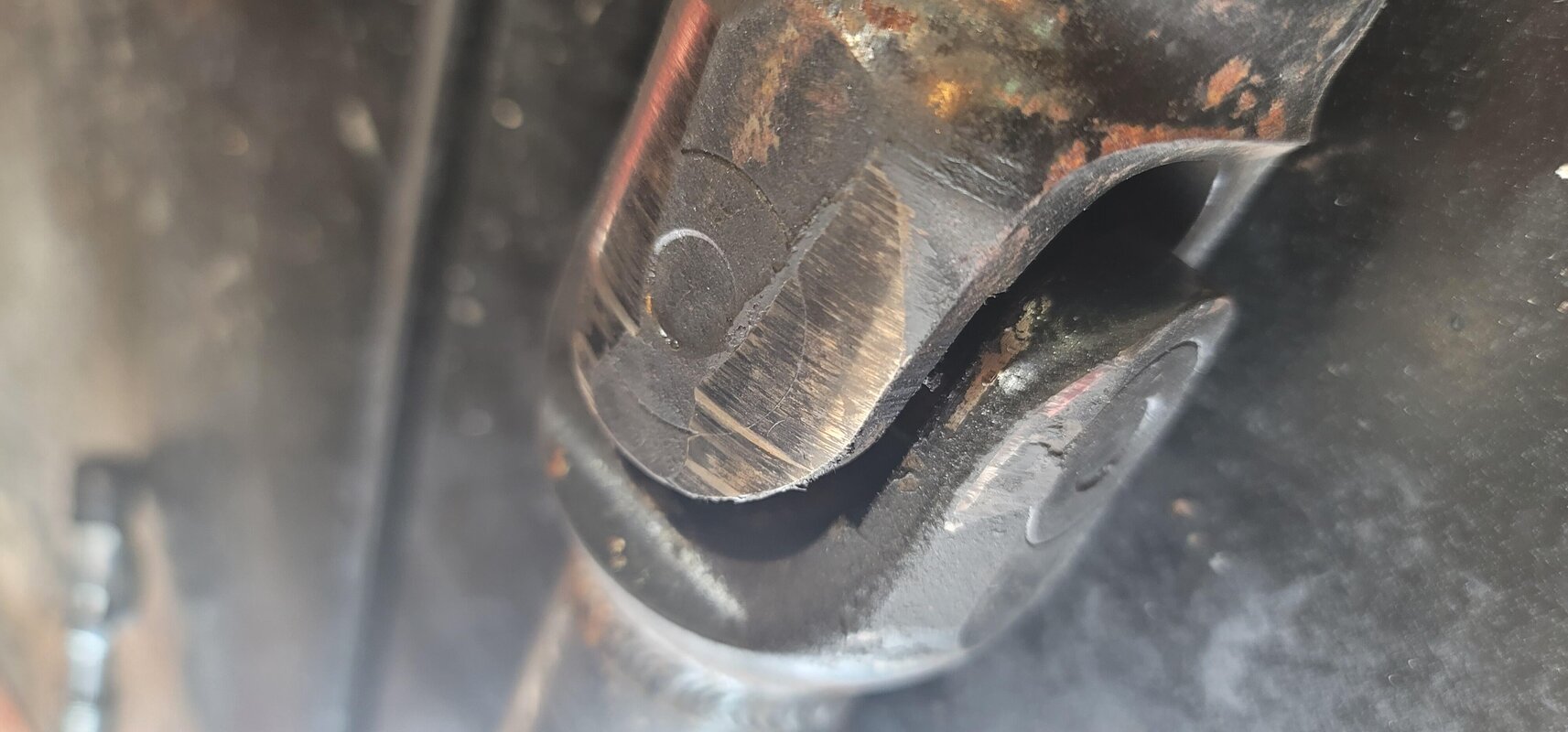

Well, I picked up my new to me 2009 gl1800 champion IRS trike on Saturday, rode it home and noticed a thumping on highway. Long story short, I pulled the drive shaft and found the front u joint bad. I called champion trike arizona and they don't have spare driveshafts, all are on backorder and no idea when will come in. He gave me part # of the ujoint, which cannot be serviced...lol. no driveline shops will touch it. So sad she has to sit on lift in garage for an undetermined amount of time. But at least I can get one someday....to the tune of $1200!. Frustrating to have a new ride and not be able to RIDE. does anyone have any ideas on how to repair this driveshaft?

If this is a staked u joint even that is no reason a joint cannot be installed
Staked joints are nothing new, the problem is incompetent mechanics have destroyed drive shafts for lack of training
If you can get your hands on a replacement joint that has internal spring clips ( snap rings) any competent mechanic can replace these joints
I could walk you thru how to do it if you like

Any help would be greatly appreciated. I posted a pic of the u joint and i will be looking tonight to see if its a c clip type. the replacement that champion called out is a c clip type one. I am so confused as to why they would say that this is not replaceable and that a new shaft needs to be ordered. I understand the need to make money but damn. If this is a c-clip, can someone tell me the process to remove and replace? I have never done this before. I'm willing to buy a press from harbor freight to do it right, it would still be a ton cheaper than the $1200 they want for a shaft that they do not have...lol20220703_173342.jpg

The picture I am looking at I do not see a staking, it may have what is called crimping, I need to see a clearer picture if you can. So if in fact the replacement joints have infernal clips they are serviceable, it is just a matter of removing the old joints without damaging the shaft. I will be here looking at your thread later today

By the looks of your shaft I see grinder marks, it must have been rebuilt at one time
This is typical of a staked or crimped joint
The stake or crimp will have to be ground off to press the joint out, the new joint will have inside cir clips, I have looked at the joint number you provided and that confirms the cir clips
Now it is just a matter of removing the old joint
I'm in luck, the old u joint has c clips so it can be replaced. I have the new one coming in tomorrow, now I just need to be brave enough to tackle it myself or just take to a shop. Thank you all for you insight. I will post up when done this weekend and let everyone know how it turned out...fingers crossed.

Great news....after finding out it wasn't a staked part, I took to local driveline shop and they replaced both ujoints and balanced the shaft while I was at work. $98 I can't complain at all. Got home, installed it and she runs like new! I'm a happy happy man. Thanks again to all of you for your help...this site is great!
