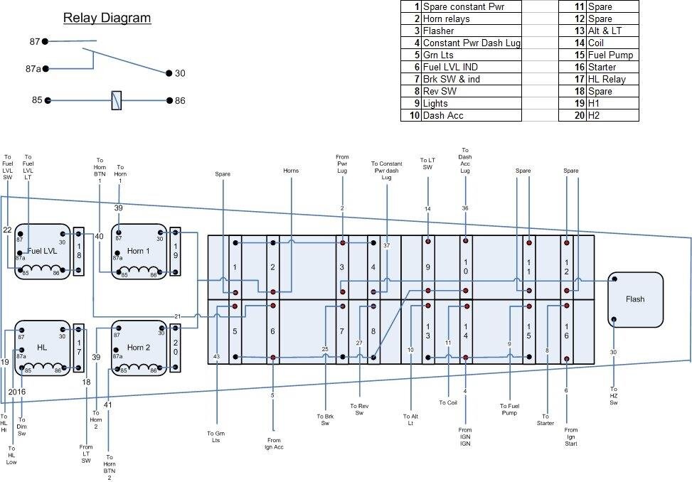

the problem came back or actualy never left
I thought it was fixed but was wrong
Should have listen to you Jack
the voltage started dropping down to 10v again
this time I disconnected every circuit not needed to actually run
it started charging fine
I then reconnected each circuit 1 at a time
It turned oy to be the Headlight circuit
Thought it was the dimmer switch but that turned out to be OK
disconnected 1 headlight still had the issue
disconnected the other headlight and the issue went away
put the headlight back the issue came back
replaced the headlight and the issue is gone
Now at idle and with everything on it charges above 13v
the bad headlight was still working just drawing to much
