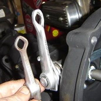

First I would use a diaphragm pressure plate of the lightest poundage I could get away with.
They take less total movement to work.
Then the long lever on the throw out arm.
Then the normal cnc style slave.
And try a 15 to 16mm master.
