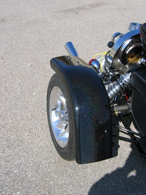

I use coilovers with no torsion bars. 7-step adjustable spring rate provides good ride under any conditions. With early trikes I built that incorporated VW torsion bars I found that properly adjusted spring plates and good condition stock shocks provided excellent ride.
