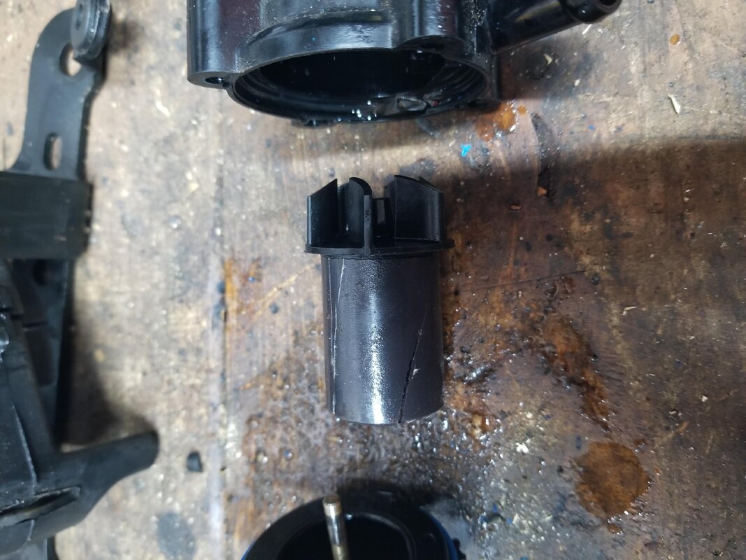

Pump, if the pump has not been changed out it is probably the pump. Put your hand on the pump and do the throttle trick to see if it starts. Mine would run sometimes and other times it would not. The Magnetic coupling was
Cracked and sticking or binding.
