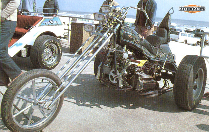

The photo on the above is the look I'd like, but I can't afford the Springer !!! …
Nope the one on the bottom, is what I want to build or a reasonable looking kinda Texas Outlaw looking trike …. I want to have Corvair motor mounted up front …. Making the overall bike shorter …. I want to use the Corvair suspension parts incorporated with GS 1200 Frame …. the Motor on the Car is held in with three bolts ….

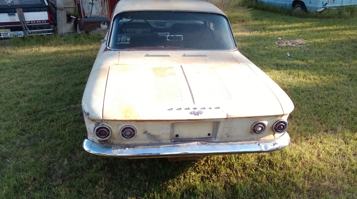

I have this '64 Corvair Monza ….. The motor will need overhauled ….

Here's a photo of the look I'm after …. Anything Yawl can suggest or help with would Be appreciated ….

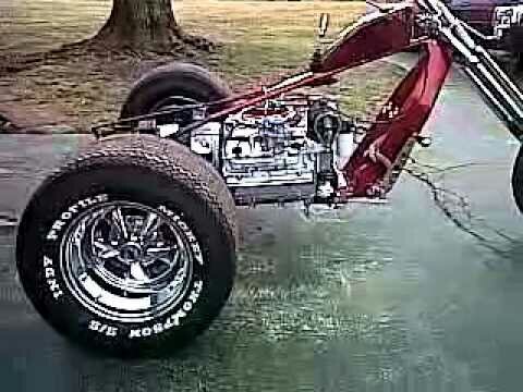

Here's what I'm thinking ….. ???
The Corvair total rear ASSY …. frame and all mounting pieces, motor & trans axle, Motor cycle man say's just swap direction of ring gear, in differential, that should work …. trouble is the old Corvair has a Automatic …. been setting awhile.

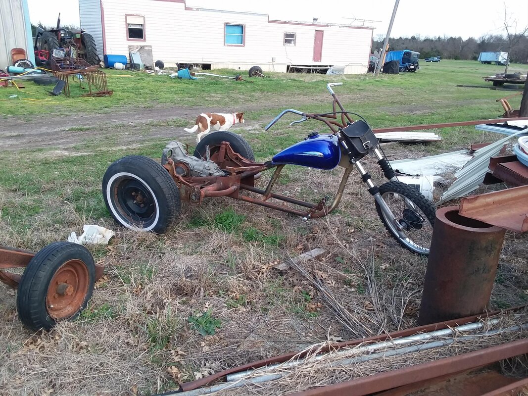

I bought this the other day for $100 bill …. I figured the tank, front forks & wheel, and VW standard tranny was worth the price ….. That being said I'm concerned about the Texas registration law on Home build's ….. I've checked the law …. couldn't find anything derogatory …. I'll read more later …. Must go to work ….
Ok Here's my thinking on the Rotation problem .... Use conversion plate to mount Corvair motor to VW tranny
Then with VW trans-axle flipped, shaft - inboard with Corvair mounted front of VW trans axle …..If I do this will the CCW motor turn the CW trans axle in the forward direction ….. I must get the Assembly out of Car and have a look ….

So I'll turn the tranny around 180 degrees …. then when a CCW rotating (Corvair) motor is put on front in midship …. the wheels will rotate Forward …. I'm ready for springtime in Texas ….

"So I'll turn the tranny around 180 degrees …. then when a CCW rotating (Corvair) motor is put on front in midship …. the wheels will rotate Forward "
True, but you'll be applying power to the "coast" side of the hypoid gears in the differential. (Not ideal) This will shorten the transaxle life. The Clark's Corvair link has some information on this.
In the picture you will see that one side of the ring gear tooth is almost vertical and the other side more slanted. The vertical side is the "drive" side and the slanted side is the "coast" side. Applying power to the drive side generates less side thrust forces due to the near vertical alignment of the gear faces. Applying power to the coast side will generate much more side thrust forces due to the increased angle off vertical of the gear faces. High side thrust forces aren't good for the transaxle housing.
Not sayin it won't work. Just be aware of the longevity issues with this approach. Good Luck and keep us updated!
I don't see where anyting would be different the Power will still be applied to the same input shaft, except the input would turn the oppisite direction unless I have to flip ring gear ..... let me study the pic's tanks by the way for the input .... I see what your saying the input shaft would be turning the oppisite direction .... which effective dosen't work like puting the car in reverse ..... I'll see what John Clark says .... about it on Wednesday ….. when I talk to Him ….. Thanks !!! VWbug !!!
Ok …. I see what your saying can the ring gear be put on oppisite side to accept CCW rotation …. I know they do it …. there's too many photos on the net with midship Corvair motors on trikes …. other than maybe turning the Corvair motor around and mounting on back of motor somehow (GM used front of Motor to the transaxle) ….. As soon as it stops raining in Texas I'll get motor out of Corvair and I'll be able to see things better …. last time I looked at a Corvair motor was High School auto mech classes ….

Thanks, as you all know it's been raining in Texas, but We had a few days of dry last week …. so I did a little to the frame I bought. …. Some photos below ….
Iron Horse 12.jpg[SUB][SUP]
[/SUP][/SUB]
I removed the tank, I bought some rust stop from My local Hardware store. after a couple of days the rust is gone and this white coating was on it.
I then painted the frame with Rust oleum Gun meatal but she turned Silver ….
Now in looking at the welding Job ….. I've seen better so next I'll get the grinder out and smooth His welding out ….. I've welded a bit …. these welds suck ….. So they will be the next to fix. Still too wet in Texas to pull the motor out of the Corvair.
Some things that are concerning Me, The shifter on the rear of trike, If I rotate the trans axle 180 degrees. I see sand buggies done this way …. My thoughts " There must be a work around "
As you can see …. to do a mid-ship I may have extend the Frame, I hope not. After moving Trans-Axle around, with input shaft facing forward, I'm hoping the differential ring gear can be turned 180 also … As the trouble with bad housing …. wouldn't be good.
One thing, I also have a 911 Motor which if not in bad shape, ( Given to Me by a mechanic ) He said " It leaks oil, could be a rod through bottom, I hope not.
