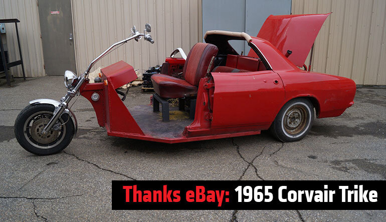

A guy is suppose to get back with me on a Corvair trike that needs a lot of work. I keep reading on the VW trike forum about valve adjustments and other failures of the VW engines. Just wondering if the Corvair engine is a more reliable ride. My first girlfriend drove a Corvair convertible and never had problems with it. Thanks for your responses here.

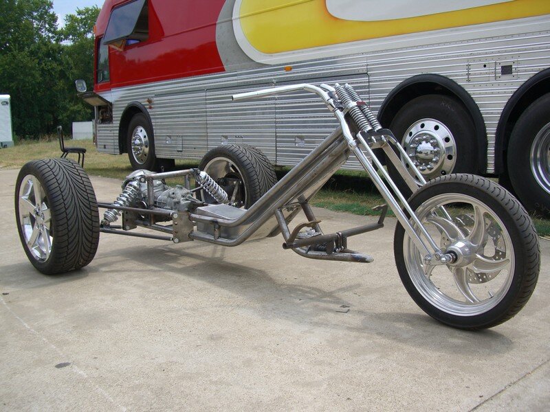

Tour Captain--We heard about the new toll bridge but always take the ferry from Seattle to visit people in Port Orchard. My wife still has a house in Seattle where her brother stays. The frame I'm hoping to find is a tube style frame like Wildman sells but longer and I see one that was going to be produced by CC awhile back but they do not respond to emails. I can have one built by one of the manufacturers out there but they have jigs that are set up for shorter builds. I'd like a wheelbase of 96" up to 120" I live by the mountains in Colorado and everything is curved. I've read a longer wheelbase smooths out the curves better. If you know about anything there please let me know. I have a real good buddy in Port Orchard and her brother in Denver that could pick on up. Thanks again

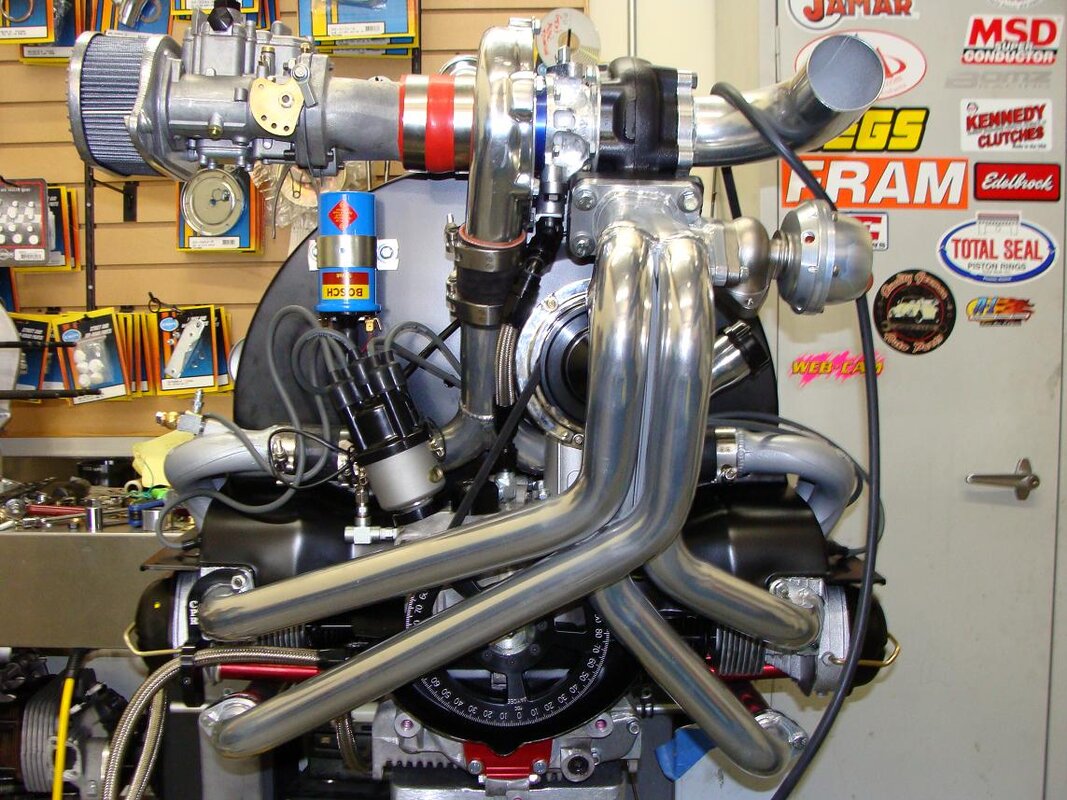

View attachment 24389Here is my engine..................just kidding.:laugh:
That is one fine looking engine.

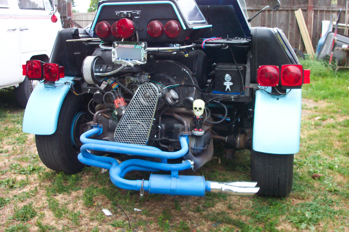

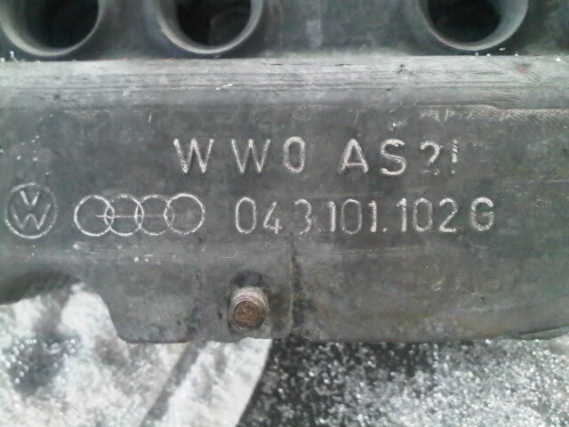

Here is my anemic little engine. Bone stock except for the exhaust. Runs great, I'm not complaining for $350. I found out after I bought it that it has AS21 cases. After some research I found that AS21 cases are sought out by performance engine builders, they are supposedly made of some sort of special alloy, made in Brazil I believe.

I've been to Port Orchard many times. They built a second bridge and now there is a toll for using it. What sort of frame are you looking for?
I have written CC twice inquiring about this frame but no response at all. Anyone know where to purchase this frame?vwtrike013.jpg

I'll research this as21 case. Like that exhaust too.

YUP--$750 for the case. One guy said made of magnesium. Made in Brazil. Found this information on Samba. $350 is a steal just for the case.
I didn't know what it was when I bought it. I got the numbers from the engine and looked it up on the internet. Apparently there is some debate about the AS21 cases. Some say they are something special, some say they are not. Doesn't matter really, I got a really good running engine foe $350.:pepper:
