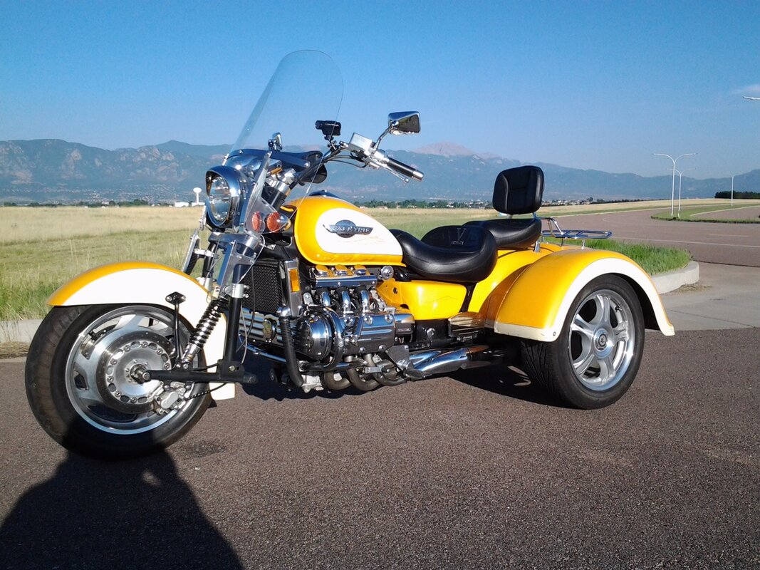

I had a 2009 with DFT conversion. It is a very good kit with some very good advantages.
1) Only adds 185 lbs to weight.
2) Uses modified Honda rear end with stock Honda Brake system. So all components from drive line back are original Honda.
The modification to the Honda rear end is to add a live axle to the right side to match the live axle to the left. Therefore the
brake caliper and rotor are same place as stock, no modification to brake.
3) If you look at the rear end assembly it looks like a really well engineered design.
4) I had no problem with handling on the twisty roads I drive all the time.
It is about $4000 more expensive than any other kit. Not a lot of options.
