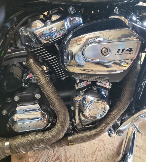

When I did the decat on my pipes last year I wrapped the pipes with titanium wrap. Heat problems gone! With the covers on you don't see much if any of the wrap unless you look for it. BTW. The pipes are made of a low grade SS. They're not gonna rust. Back in the day, headers for cars were made of basically auto exhaust pipe. The wrap would trap moisture and rust found the perfect home. The thin walled pipe didn't have a chance. Hence the old wives tail that the wrap would rot your headers. Back then they did. And cheap headers still will. Many now come ceramic coated from the factory.

When I wrapped my 20 Tri Glide with DEI titanium wrap, after one year it disintegrated. Went to DEI asbestos wrap, no
more problems. I would be interested, how well yours hold up..
You will surely need larger hose clamps for the heatshields if you use both wrap & liners.
Need new clamps even if you just wrap the pipes. I know I did! Definitely, if you do both.
