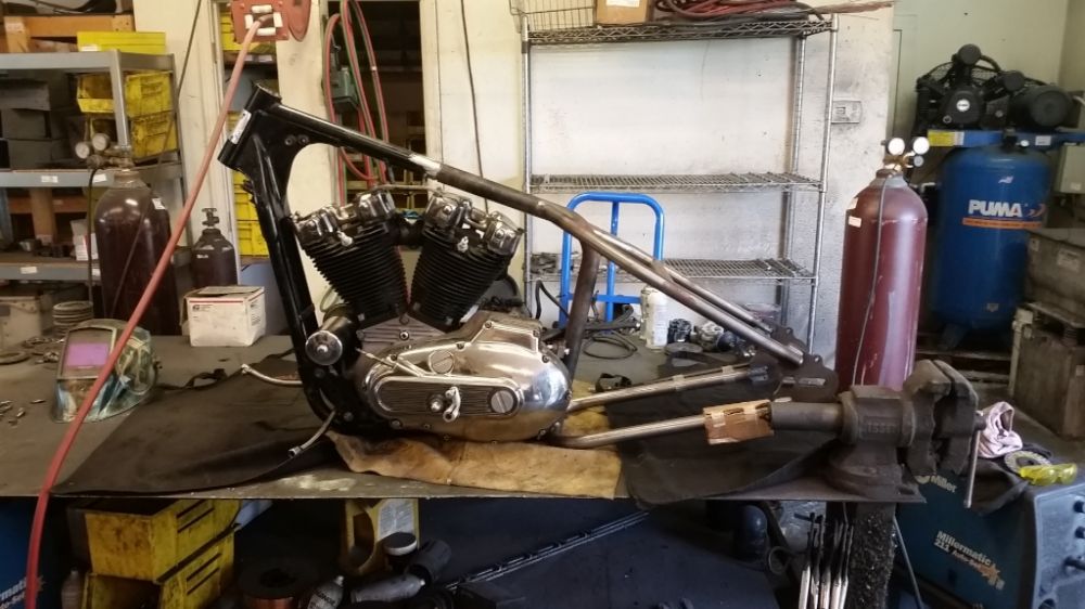

So far, the only help I have had was from my kids helping me lose nuts and bolts. The next step required spot welding the frame while the engine is bolted in to act as a jig... Removing the engine to complete the welds... Then re-installing the engine. I figured it would be best to have a bring-your-project to work day...
80-ee619541_2285_46df_8ad6_b86b740f2848_zps3d7littb_3b30c190ef0df814c0c2822584e58545867948fb.jpg
Did a little of the welding...
A job better left to the professionals... Devin did the majority of the welding...

And smoothing some welds with a flap disc...
Something to take note of is the 1/2" threaded rod used to apply spreading force against the inside of the axle plates. This is crucial to prevent the frame rails of the hardtail from warping inward when welding, especially when welding the seat cross member tube...
80-5ed10739_a2bf_4baa_b28b_8db9c1195b0d_zpsj24wfjn5_0650e6ab87594b48eb1e8851d1e57d555c733aec.jpg
And just like that, the frame is welded and ready for the mock up stage. Ill be un-loading this thing myself so... who says lowered trucks serve no purpose???

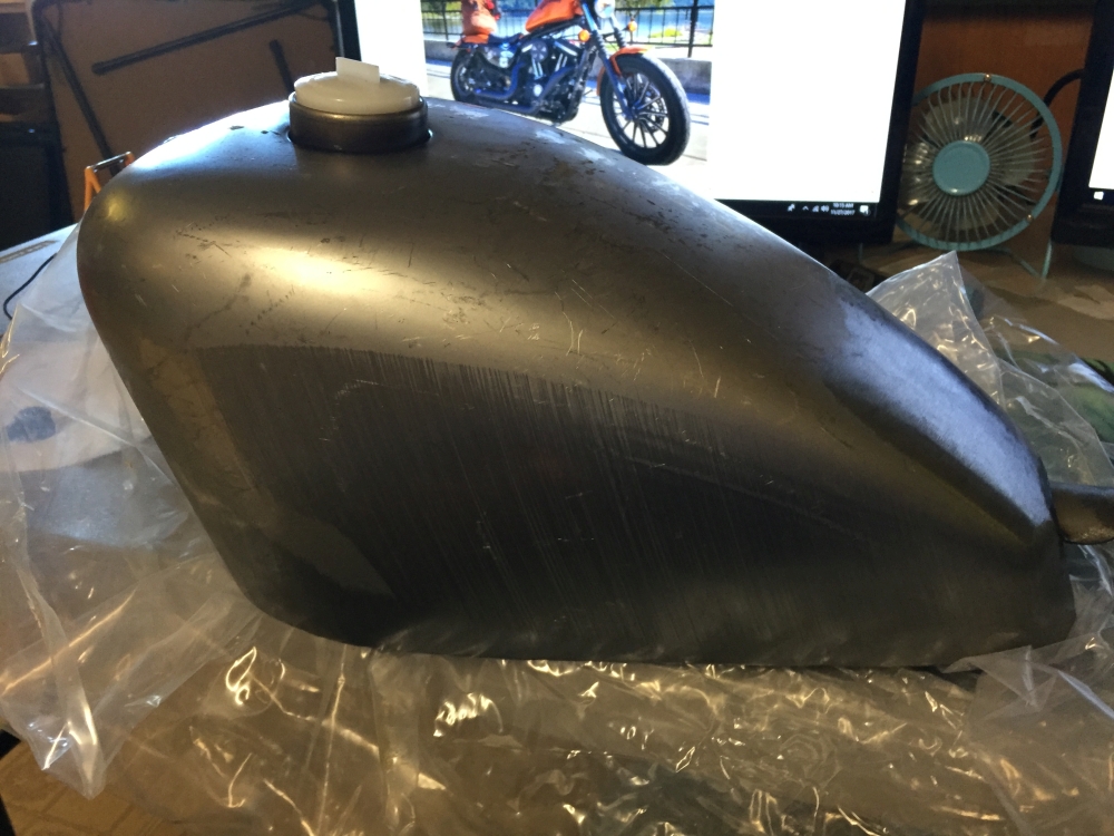

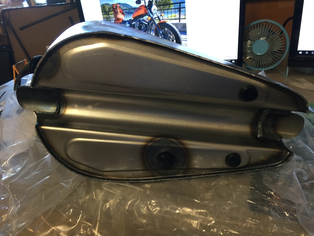

As of now it is a waiting game for parts and supplies, so I took it upon myself to mock up the tank and see how it looks on the bike...

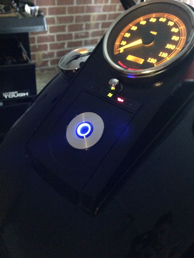

If budget allows, I will be replacing it but for re-assembly and test running it will do for now.Also spent a little time on the dyna installing the push button ignition switch. I will most likely be doing a similar setup on the ironhead...

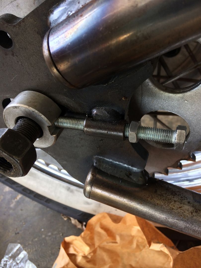

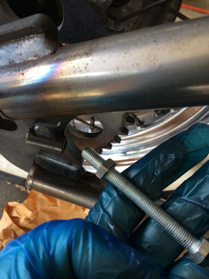

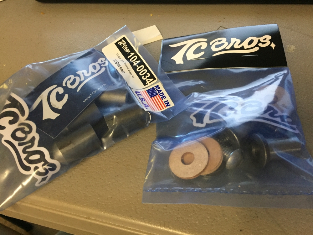

Didn't make much progress but I did find time to install the chain and adjusters. A really nice thing about the TC Bros Hardtail is the threaded chain adjustment fittings are already welded in place and include the needed hardware....
With the Jam nut in place, the bolt threads thru the adjustment and into the notch of the outer axle spacers...
Chain was then test fitted and a full link needed to be removed to shorten the length...
Without a roller chain breaker tool, I usually do this with a flap disc. It seems to be a more delicate way to wear the outer link down without damaging any other links...
With the link removed, the adjustment is still maxed out, So I will likely be removing another....
But not today!

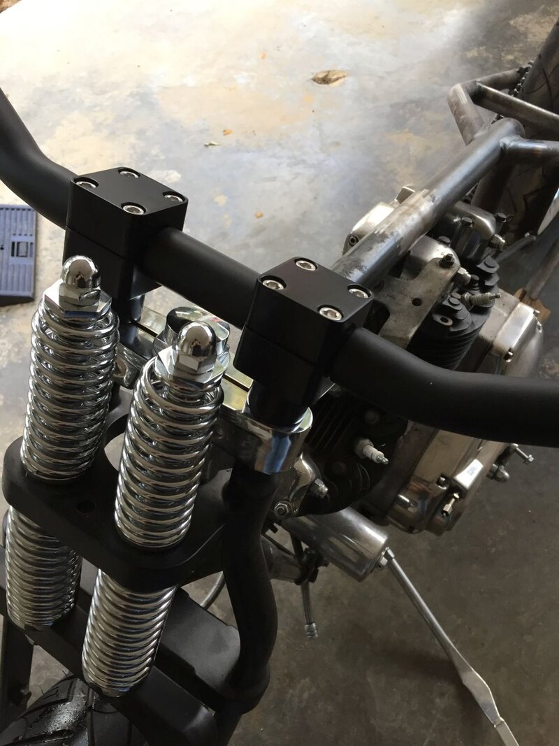

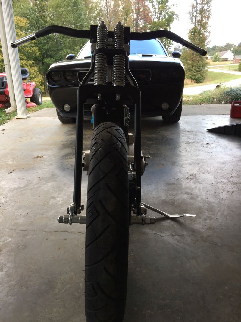

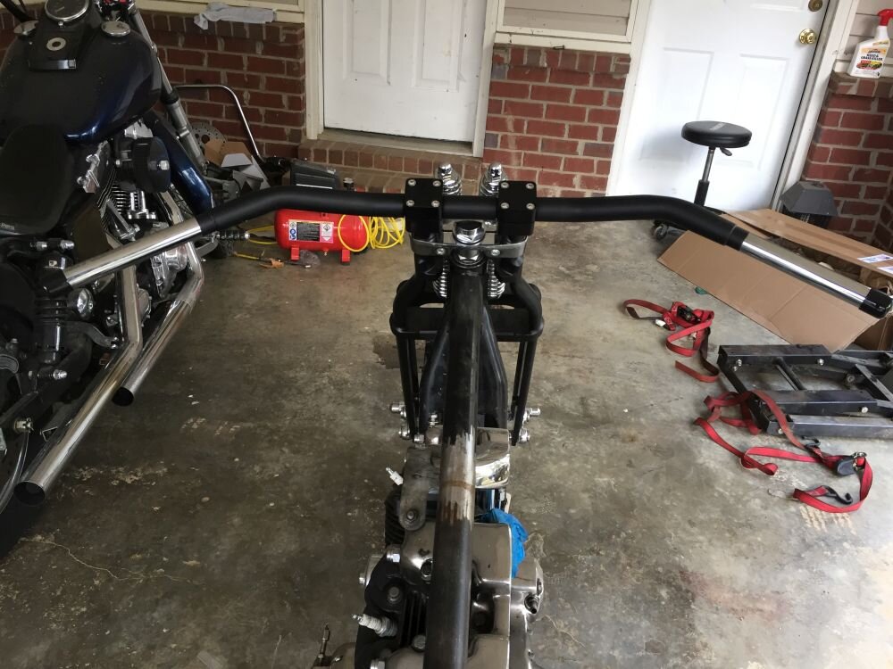

Decided to mock up the -4" under springer. It has been in the back of my mind that it would be too low... Even with my measurements and calculations, I have been wrong before (Found out later I was right about that :cool:)
So, before we see what it looks like, A little money and time saving tip... The neck/steering stem bearings can be purchased at your local parts store for a fraction of the cost of OEM. Autozone Part# is BT100 and comes with both bearings for $17... The dealership wanted $30 and didn't have them in stock.
I will get better photos of the install process when I do the final assembly but for now, I think these will do...
It actually still has a good bit of clearance and I am more than happy with the ride height...
