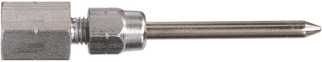

Hmmmmm, I'm unfamiliar, with the words Moog U joint and Pin point adapter from my grease gun (sorry)
My grease gun is the "regular type" with a flex rubber tube with an "end fitting" that plugs into a grease jirk.......Than I pump the handle.
Been using this type grease gun for over 50+ years

I had to use the pin point adapter for the drive shaft on my EX-Slingshot....Think of it as a long hollow needle to fill the Zerk's in tight spots where the regular head is too wide/fat to lock on the fittings...It doesn't go over the fitting it just pushes the ball in the fitting to let the grease in... ...

the pin point adaptor looks like the picture here, you can find them at any good automotive parts store

The needle attachment is only used to get into tight spots because it doesn’t clip onto the Zerk sometimes you wish you had three hands two to hold and operate the grease gun And one to hold the needle on the zerk..
Thanks Jack, I will check this out this morning while visiting my local auto parts store this morning... (i need to get a couple cans of 5W-30 oil for my wife's Jeep with 175 K miles on it.......)

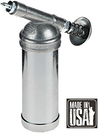

Ronnie, I have 1 of these also , it works very good and easy 1 hand pumping, you can find them on Amazon, or a Matco tool truck
