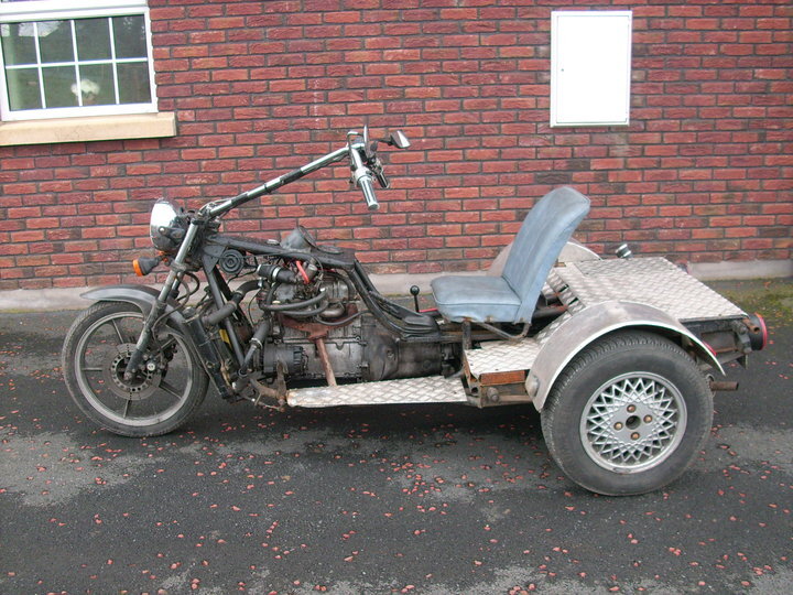

I also know a guy in Casper, Wyoming that has a home built trike with a small V-8? that still runs from many years ago that he may have had trouble insuring?
he used to ride it years ago and still starts it up once in a while. Its nothing fancy. but darn sturdy.
Hey, that's COOL! That's much like what I am after and I'd go for that in a second!
What do you know about it?
I know nothing about it, just a picture from the internet. Do a Google search of "Reliant trikes". It seems that across the pond in Great Briton people like to make trikes out of Reliant three wheel cars. You might be able to get some ideas on building a car engine trike. Old VWs make good trikes also without spending a small fortune.ThumbUp
