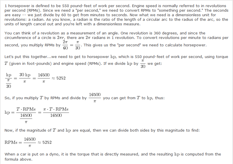

Dynographs: Why Do The Torque And Power Curves Always Cross At 5252 RPMs?
I'm confused. Did you take calculus in Kindergarten MarkFL?

The equation demonstrates the fine interaction between "torque" and "horsepower". After years of experimenting with different cams, in my Harley days, including purchasing custom grind cams, I came to agree on one basic conclusion:
A quote from Woods Cams
"It's not how fast you go. It's how quick you get there."
Woods was right.
"Torque motivates.
Horsepower accelerates."
That's why a higher torqued engine with the same HP as another engine, will get to the finish line quicker. The high torque allows the engine to shift quicker into higher gears and lower RPM's. Higher HP engines require higher RPM's and longer shift durations.
So the magic intersection at 5252 RPM's says "torque" has done its thing and HP is now in charge.:Coffee:
