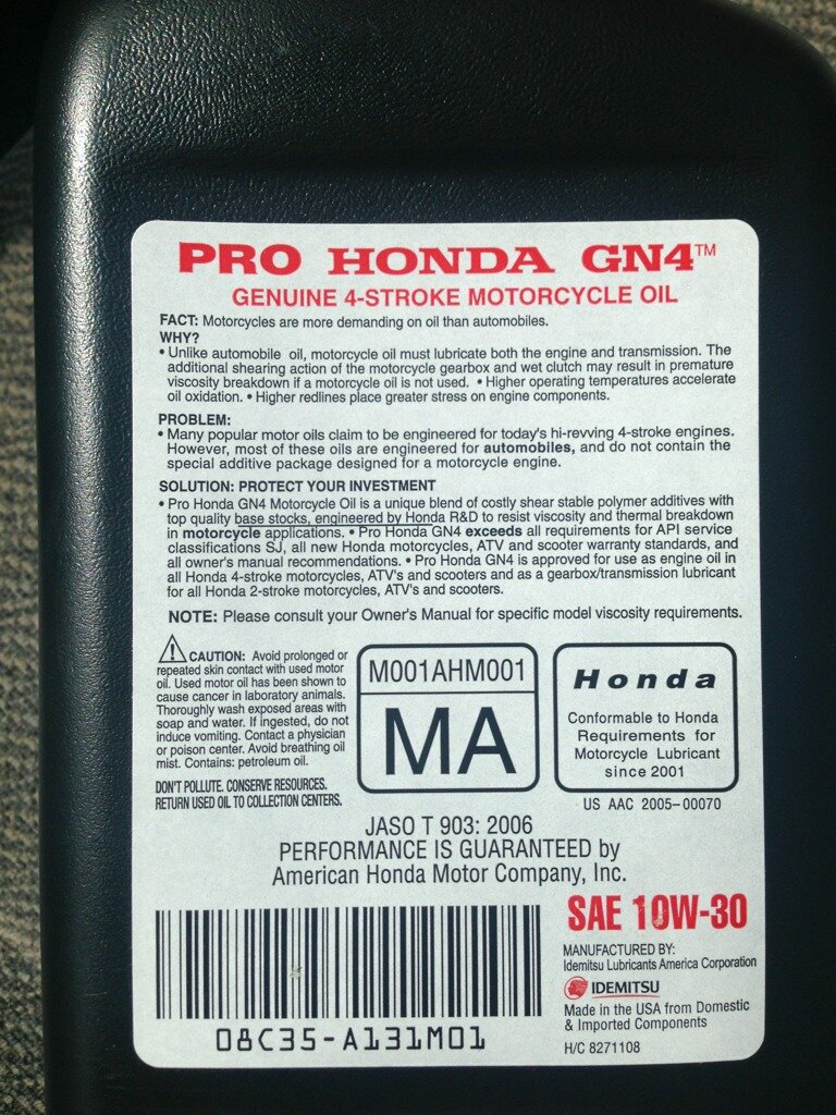

Do not use any oil that says, "Friction Reducing", "Contains Moly", "Energy Conserving". Must read, "Safe for wet clutches".
Must also be JASO.

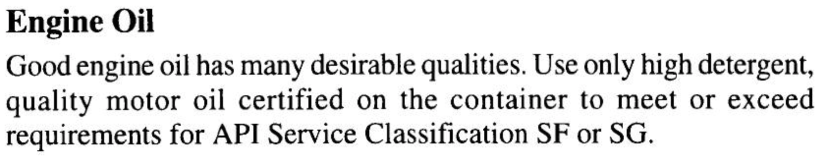

All good points on MC oils. However, my shop manual says use motor oils that meet or exceed SF or SG API certification. I do go the extra step to insure that it meets JASO standards, as well.

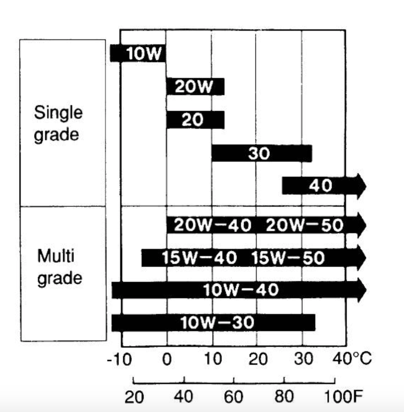

Another consideration is the weight of the oil. I know locally, if you take your GW to the dealer and ask for an oil/filter change, you'll get 10w-30 GN4. They say it's because you'll get better fuel mileage. But mother Honda's chart on oils, shows heavier oil for use at temps above 90*F, which it is here for much of the year.
