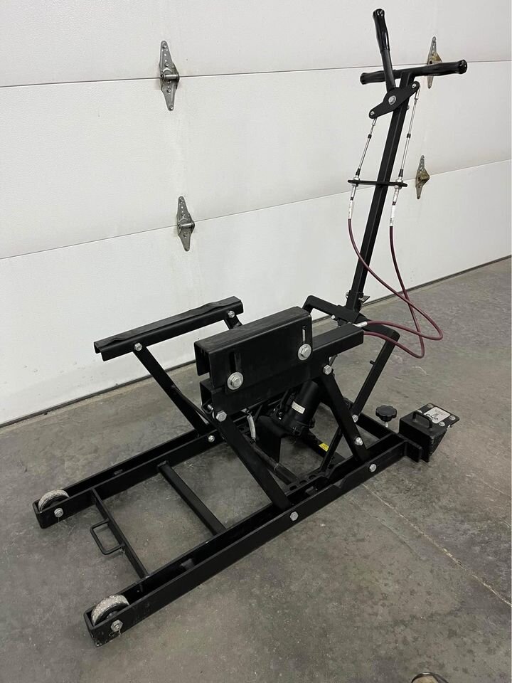

417293702_24548392808140902_20694134180481727_n.jpgI have access to a J&S jack with the trike adaptor on it. He said it will fit Pre 2017 trikes. I have a 2022 Tri-Glide. He also said it won't fit his 2023 trike. Anyone know if they changed the frames since 1017?
View attachment 116374I have access to a J&S jack with the trike adaptor on it. He said it will fit Pre 2017 trikes. I have a 2022 Tri-Glide. He also said it won't fit his 2023 trike. Anyone know if they changed the frames since 1017?
I too bought a J&S Jack that fit my 2016 from the right side. From 2017 forward you have to jack from the left side. The only thing I did was switch the components to opposite sides and everything works as it should.
If you have relocated your oil filter, you will have to move the pump pedal back a inch for clearance. All this takes is drilling another hole for the screw that holds the pedal in place.
