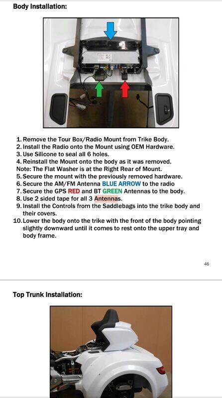

I called CSC and talked with Dwight and Will. The FM antenna is placed on the top inside of the tour pack. They said they have not had any complaints about poor radio reception. They also said there is no external antenna that will fit the Honda radio. Apparently the plug to the radio is very specific to the Honda radio system and there are none available to match. I guess I’ll just have to live with it.

The antenna is placed inside the top tour pack between a plastic liner and the top shell of the tour pack. NJ Mike tried to take this plastic liner out but was unable to do so. Will at CSC said they tested the antenna throughout this whole area and found no difference in reception.
