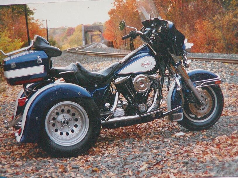

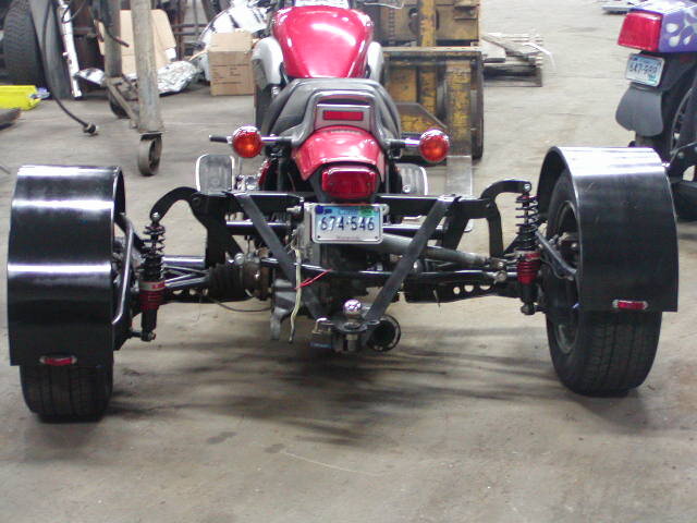

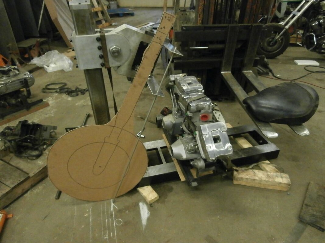

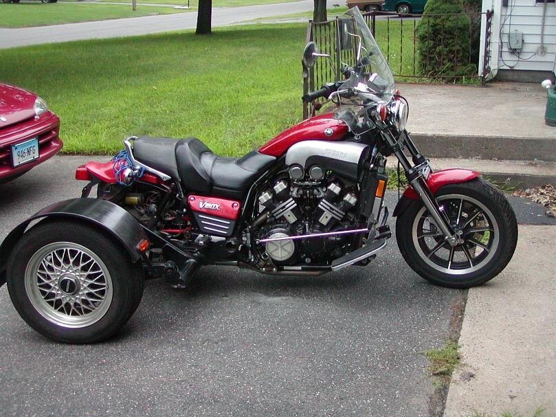

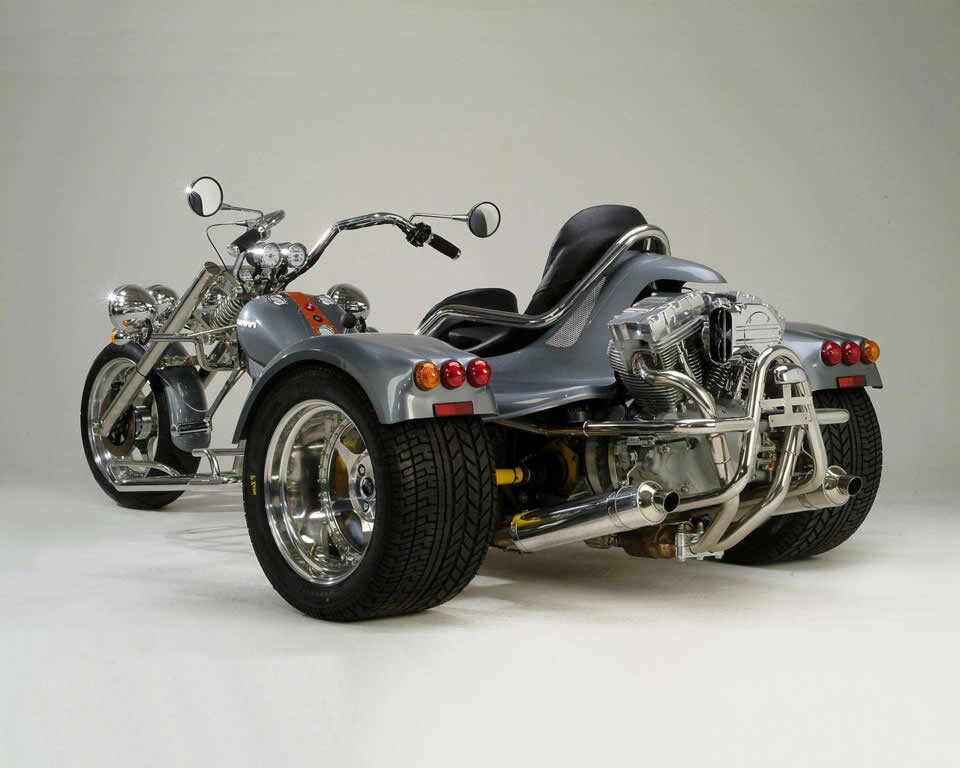

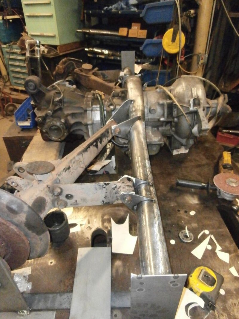

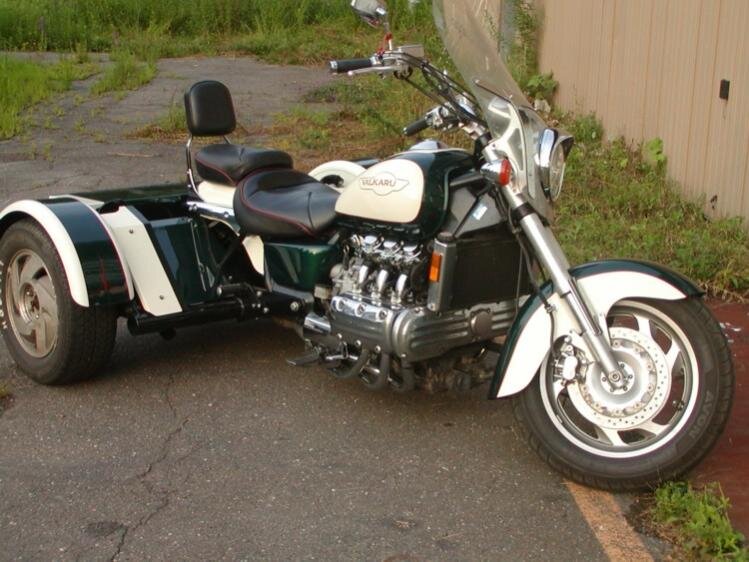

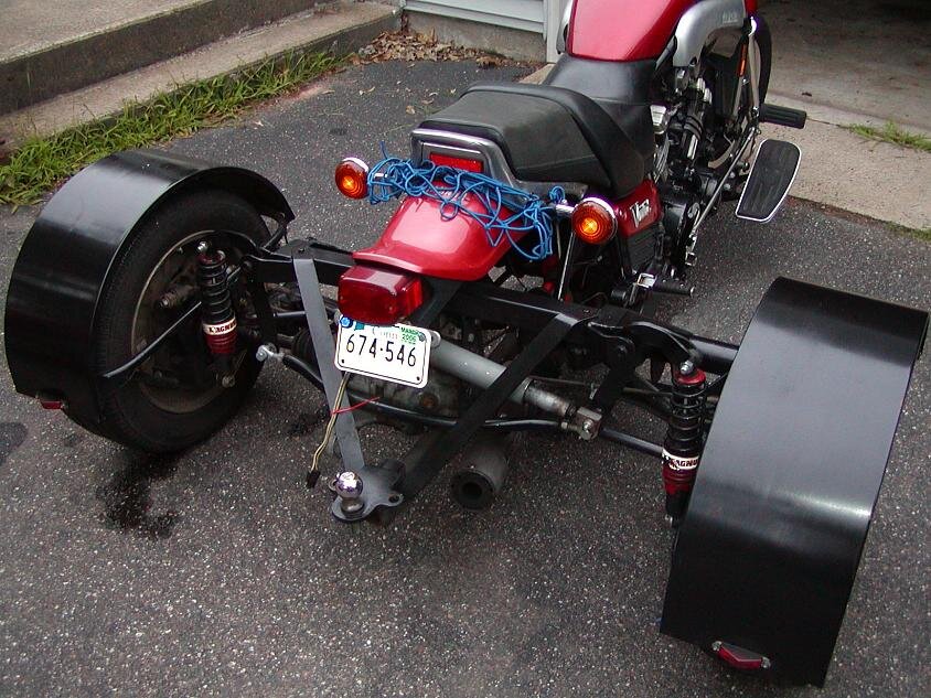

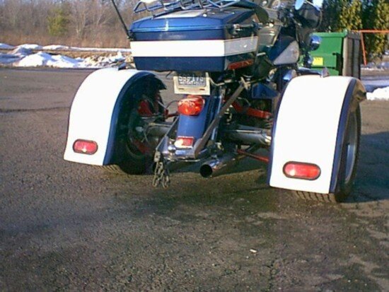

i have built a few... all bike based...my first was suzuki t500 2cyl 2 stroke hard tail.... i rode the piss out of that thing but i was about 21 then... every thing since is independent rear suspension.... really not that much work... if you are going shaft remember if drive shaft is on the left of the bike a car rear will need to be upside down... dont worry about running the gears the wrong way not an issue... as for the front end i find i like about 1.5 - 2.5 inches of trail with the rake around 30 - 35 deg... if you use a telescopic front u WILL need raked trees.... willing to bet that was the biggest problem w the vw you rode had toooo much trail...
make it very hard to turn but most ever trike i have done i was happy with how the handled nothing is cast in stone and there is no best way...
ask 100 different people u will get 101 different answers couple pics below..

NICE Fabrication.....ThumbUp:10:
