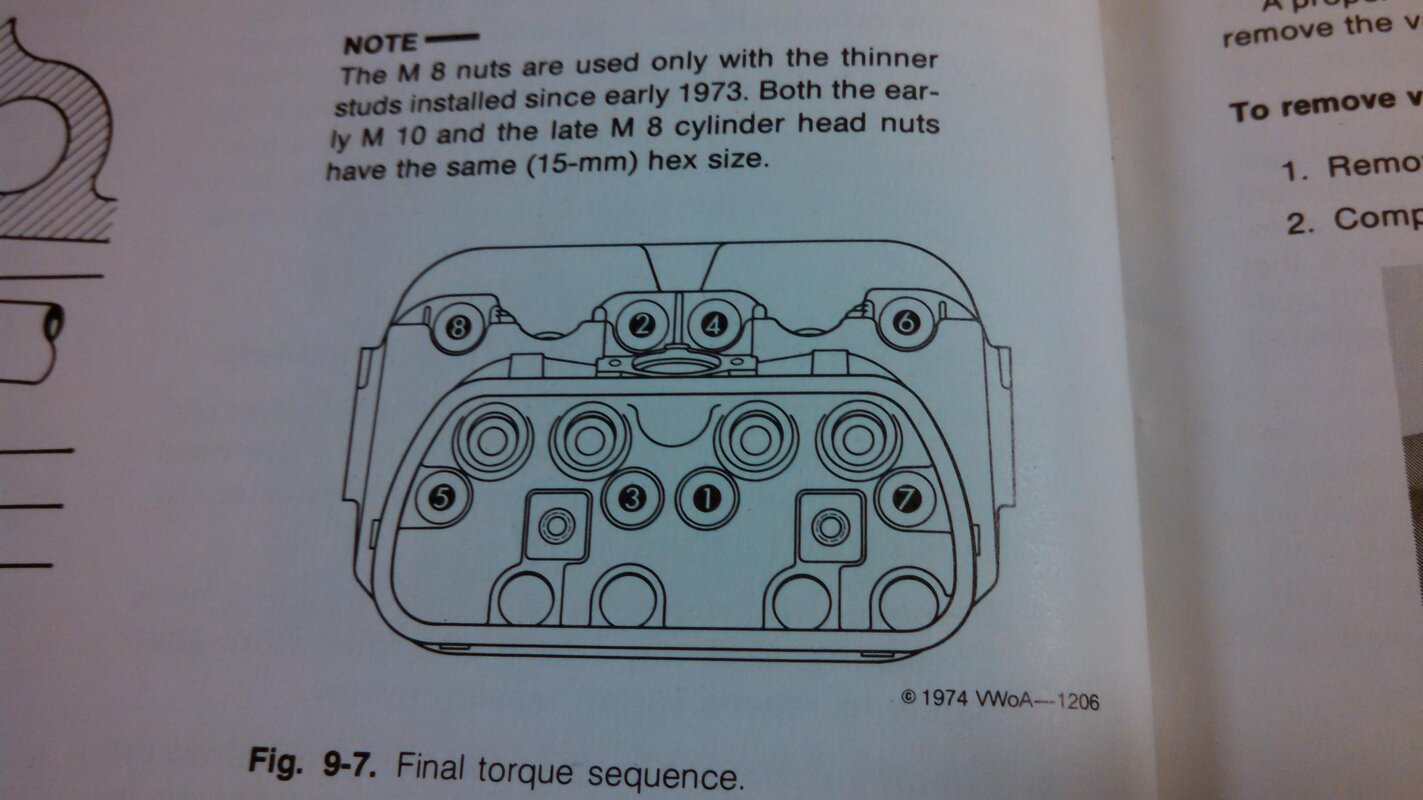

2.) Next question, is there a specific pattern one should follow when torqueing down the head nuts?

There are 2 torque sequences:
Remember, aluminum engine.
