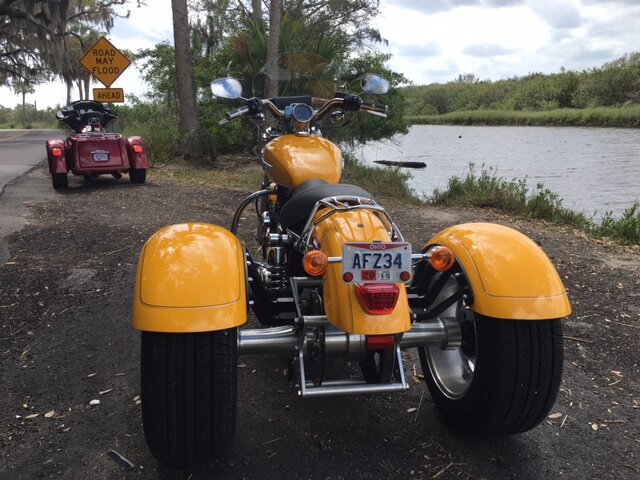

I do own and ride a 1200 Sporty/Frankenstein, but I am a small woman and solo rider, so could not offer any perspective on your specific questions. I suspect that most of the riders here with similar setups probably usually ride them alone, as I do, and that may be why you haven't gotten much response.
That said, the trike is a blast to ride, and has no trouble keeping up with my husband's Triglide. I think Gorilla's comments sound very reasonable to me.

Love your trike color is amazing. How long have you had it? how many miles have you put on it? Any troubles at all with the rear end? I noticed it is quite narrow, how does it corner compared to your hubbies trike etc.. does the wheel ever come off the ground when cornering ext. The reason I am asking all these questions is I am seriously trying to decide whether or not to build one. I do have a 2015 freewheeler which I really like but the new stuff like hydraulic clutches. none drainable forks, fuel injection and stuff like that are too hard for me to do by myself. I like to do my own matinence and the new stuff is beyond my mechanical ability.

The bike is a 2011 1200 Custom which I bought last winter from a lady who had put almost no miles on it after laying it over in her own garage. I have been riding three wheels since 2006 and have no desire to return to two, so as soon as I bought it from her, I ordered the Frankenstein kit and had it installed. We are snowbirds in Florida, and this little trike just stays here so we don't have to trailer two trikes back and forth. Last winter I put 2,000 miles on this one before heading north in the spring, and have added about 500 more in the past two weeks.
You are correct, the wheel base is narrower than the Freewheeler's, and also narrower than my Fat Boy/Champion kit, but handling is excellent. I've never had a wheel lift in turns. While I am aware that it is a possibility, I have never felt it was likely at all. The steering is quick and easy with the rake kit installed (came with the trike kit from Frankenstein). The short wheelbase of the sportster possibly contributes to feeling bumps a little more than the bigger trike, but it certainly has not diminished my enjoyment or been uncomfortable for me riding solo.

Luuuuuuuv that chrome yellow.:D
