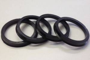

Here is the deal with the Cragars....
The bolt pattern on H-D trike rear wheels is 4x4.25". Stock Harley trike rear wheels are 15x5.5" with 2.85" backspacing. The Cragar I am using (15/14 SS) has a backspacing of 4.5”. My adapter is from Wheel Adapters USA and is a 4x4.25 to 5x4.5 adapter 2” thick with a 12x1.5 lug thread. So the Cragar at 4.5” backspace with a 2” adapter nets out at 2.5” backspacing and is very nearly equal to the stock Harley back space. Since I am fabricating the fenders... it all works well.
But......
Your wheel adapter MUST have a centering hub. Either built in or made for the purpose. I turned one down and made the insert for mine. The classic SS series has slotted holes and that means your (safe) installation relies on the centering hub to install the wheel. See below

You will get two sets of washers with the Cragars.... Use the offset hole washers to hold everything in place

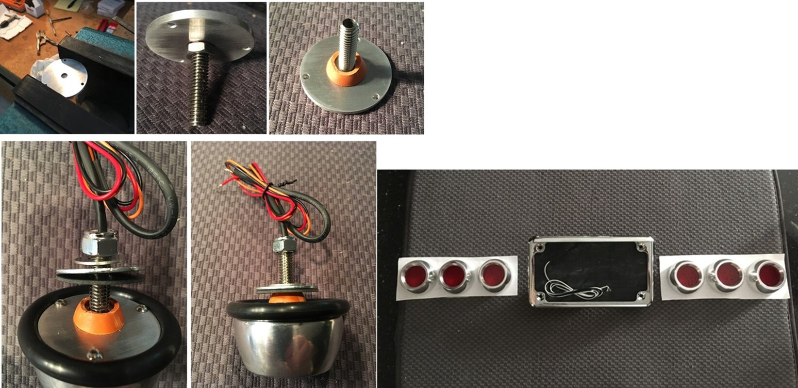

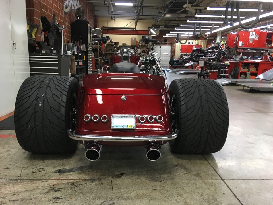

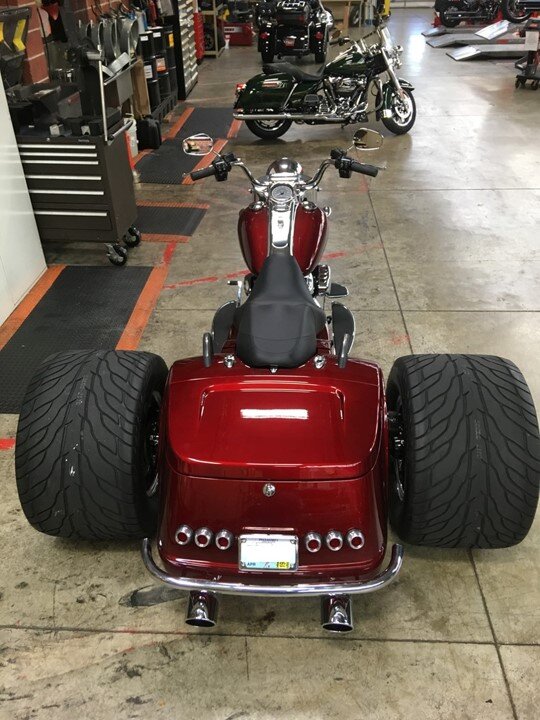

Got the tail light mounting figured out. Going to start drilling holes (after measuring 20-30 times first) and mounting/wiring them in this week. That paves the way for the fat tires to go on.
Can't wait to see the finished product. I'm going to do early 60's corvette lights. Doing an all inclusive plate frame for now. Next week (I hope) handlebars, performance upgrades and dyno tuning. Having trouble finding the spacer/adapter with a centering hub. Did you get the direct drill wheel?
No not direct drilled wheel.... Cragar Series 08/61 S/S Super Sport - Multi Fit/Vari-fit utilizing Mag Lug Nuts w/ Cragar Washers. 08/61 Series wheels require traditional Cragar S/S Mag style lug nuts and off center washers for installation. Take a look at their website and you can see. The centering ring in my adapter is also part of that connection. I had the same wheels on my GTO as a teenager. Not complicated really. I just needed a certain wheel size to go along with the fat MT tires....

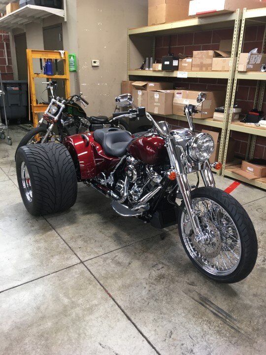

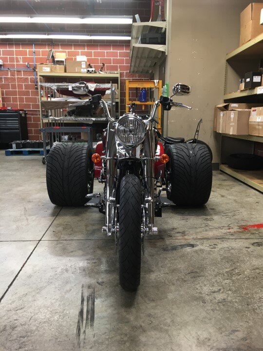

Tail Lights still coming together. Fenders off and fat tire check went ok (Thank you Lord). Waiting on the hub-centric rings to line everything up and then on to the fender building.

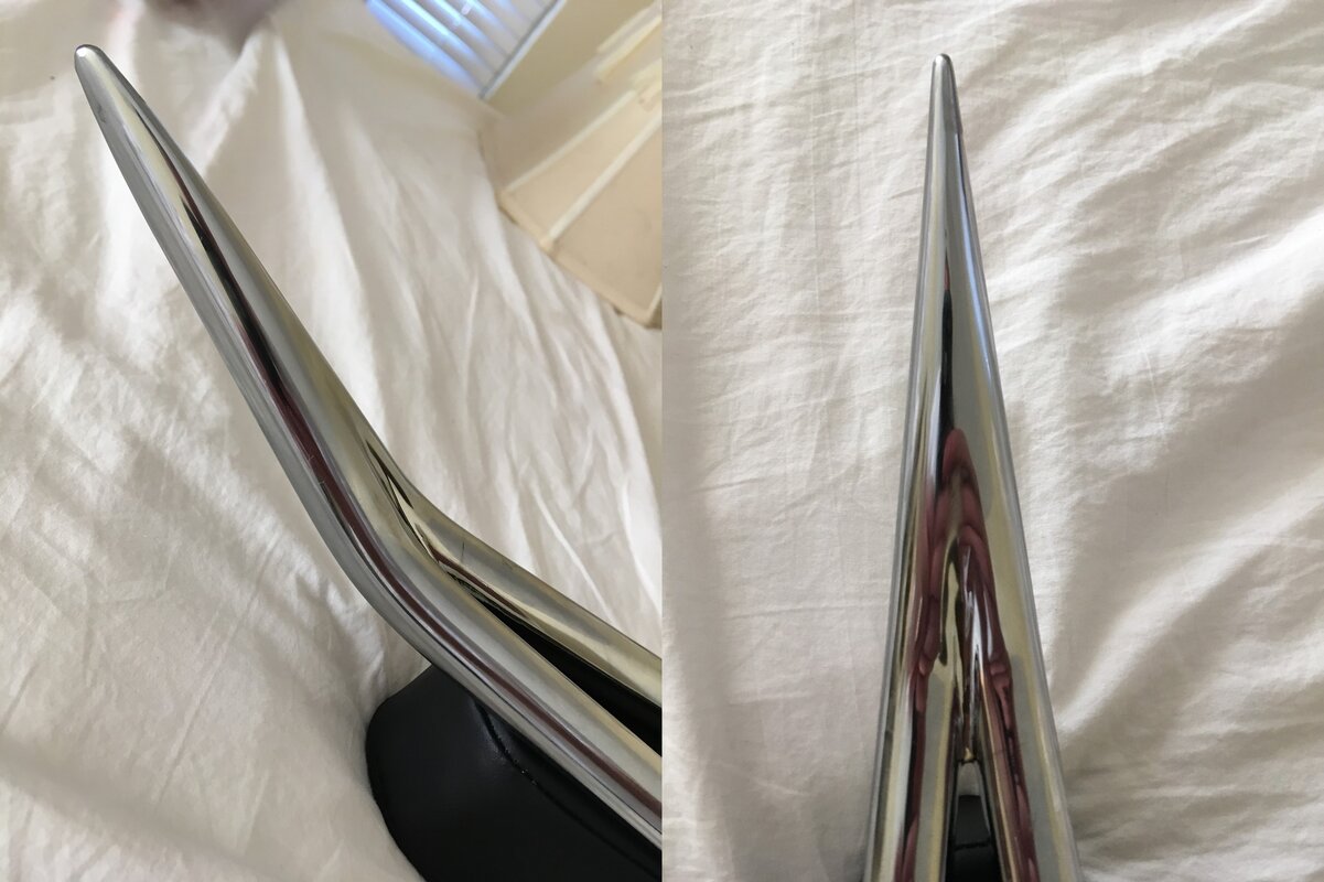

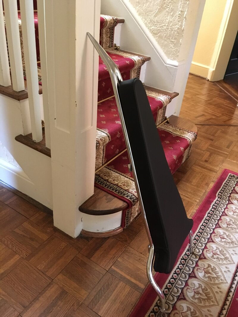

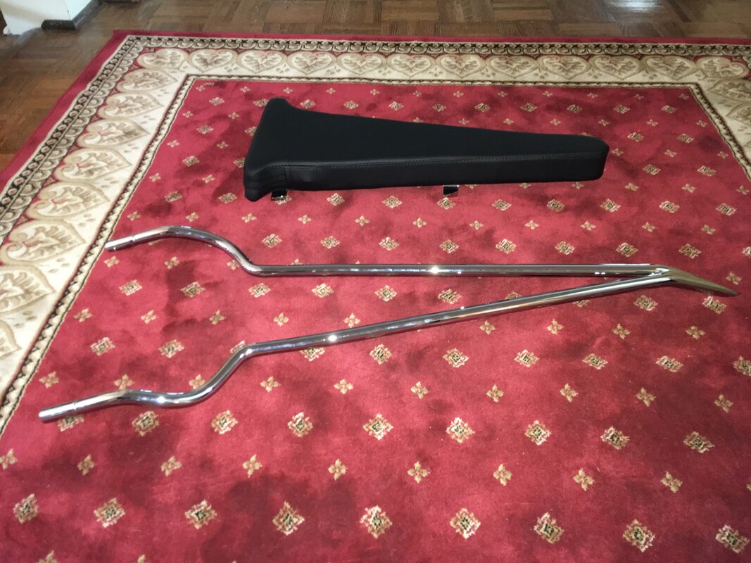

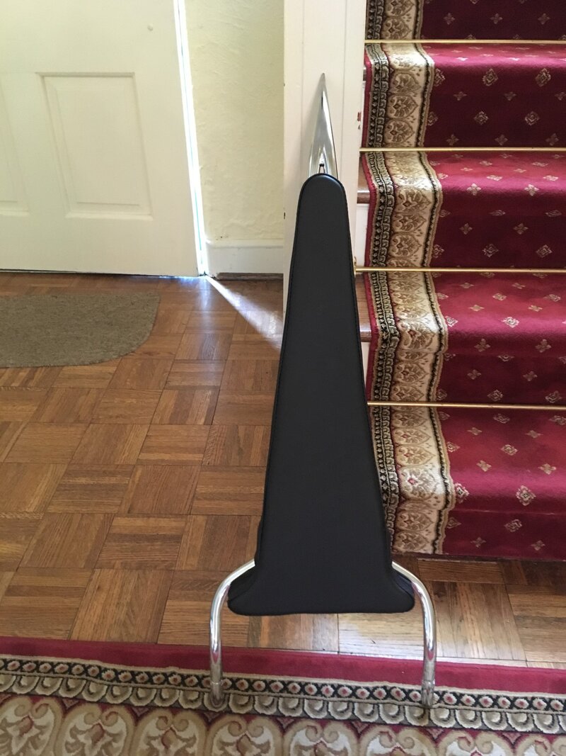

Sissy bar came today.... Looks AWESOME!
Unfortunately, it will have to go back. The attach points for the pad are not located correctly and the seat pan will need rework....
Frustrating.... but doesn't keep me from riding
The quality of the sissy bar is so superior to the old AEE pointed one I used to have "back in the day".... For those who ran them (usually on a hardatail frame)...do you remember how they used to crack right down the middle at the top of the point. Then you would grind, re-weld, paint with a little galvanized fence paint (and hope nobody noticed) and then they would crack again.... (sorry for the war story but it adds context to the next comment)
Look at the quality of the welds and polish work on this bar..... Nice
Ginz Choppers does a great job.... They just exercise your virtue of patience
