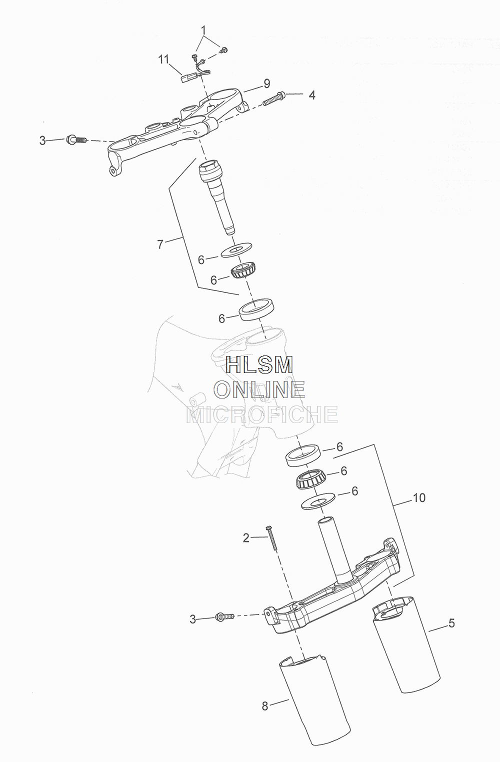

What kind of bearings are in the HD steering head?
I joined TT for comments like this. The little details are priceless.
Timken tapered like this
