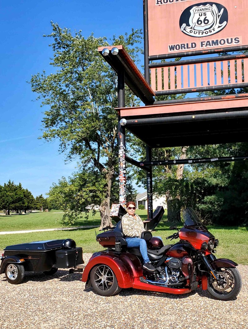

Had a RoadSmith conversion done to our 2018 CVO Limited last spring. I am generally very pleased with the outcome.I could have sold my CVO and purchased either a TriGlide or a CVO TriGlide and had less money in the final trike, but I decided not to. There are 4 main reasons we decided to go with a conversion.
  1. My wife loves our bike. We did a lot of work to control the buffeting and she just loves the color.
  2. Ride quality. Our conversions fully independent rear suspension with performance sway bar beats the heck out of Harleys solid axle / cheap shock design. My wife has Fibro Mialgia which makes long rides tough on her, but she has no problems doing 400 miles days on our trike.
  3. Reverse. Just admit it, Harleys reverse system just sucks.
  4. Aux gas tank. We got the 3 gal aux gas tank option on our trike. This was the actual reason why I went with RS instead of CSC. With the aux tank we have done 180 mile mile runs between stops while pulling a trailer with the cruise set at 80 and the bike still indicated 70 plus miles to empty! The aux tank makes all my range anxiety go away!
Anyway, my point is that IMO there is no contest between a TriGlide and a good conversion.

Love your paint on your bike.. your RS conversion trike looks very cool..
