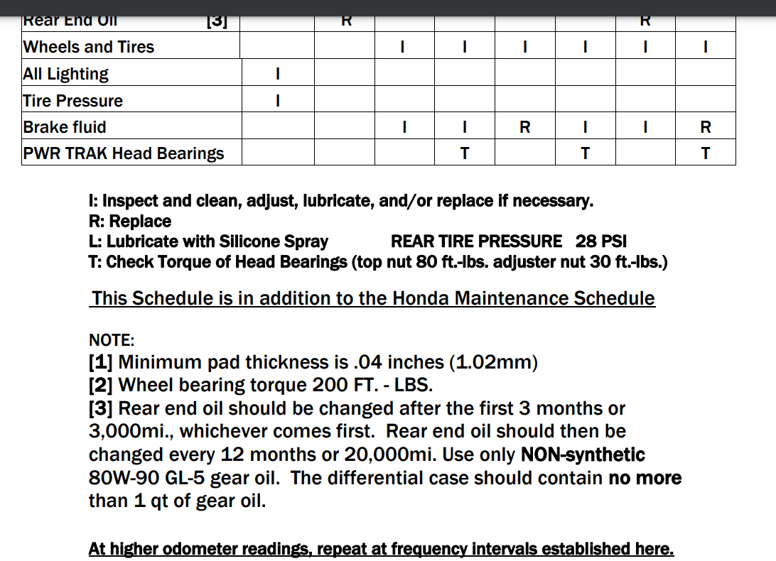

Per CSC 2017 Owners Documentation/Manual
The 2017 manual states: "Use only NON-synthetic 80W-90 GL-5 gear oil. Change after the first 3 months or 3,000 miles, whichever comes first. Rear end oil should then be changed every 12 months or 20,000 miles. The differential case should contain no more than 1qt of gear oil.
