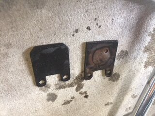

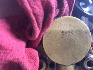

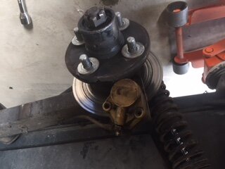

View attachment 59449looking for part numbers for brembro brakes on a champion escourt
The Brembo brake Pads might still be available if you could provide me with a picture and dimensions of the pads. The Caliper may still be available too, if you can find a part number, but the rotors are pretty much non-existent. You should probably upgrade the brakes to the newer versions that are readily available.
I went through my disc brake pad catalog and only found one pad with dimensions similar.
The EBC FA115 pad is the same one used on the earlier Motortrikes.
Your measurements were 1 3/8" X 1 7/8" or 1.375" X 1.875" or 34.9mm X 47.62mm.
The FA115 measurements 1 7/16" X 1 27/32" or 1.417" X 1.771" or 36mm X 45mm
The difference is 1/16" and 1/32" respectively.
The catalog does not list a Brembo caliper being used. A better picture of the caliper would help too.
