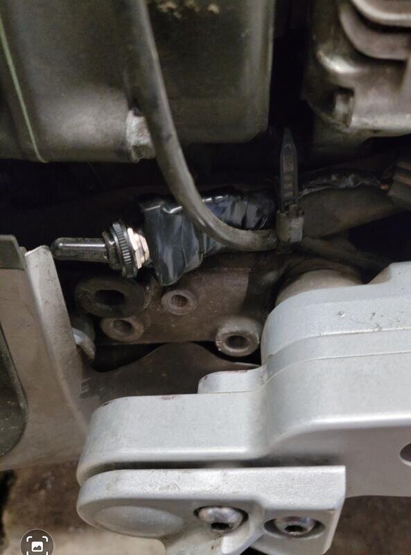

Well after the talk about adding a switch, I decided to go ahead and do it. Honestly I wanted to do it more for if the FI light showed up so I could check and get the error codes but could be a little cheap insurance as well. I took the sidestand harness off, removed the protective covering, clipped off the splice the trike installer put in, crimped on some connectors, hooked them up to the switch and wrapped it up tightly with electrical tape. I put the green wire on center spade of switch, green with black stipe on one of the outside spade and the yellow with black stripe on the other outside spade. Flip the switch one way and the orange "S" light shows up on the dash. Now bike will kill if someone tries to put it in gear. I flip it the other way and the light goes off and bike will start and run normally. It tucks in nicely behind the chrome engine cover.
I picked up the switch here:
Baomain Car Toggle Switch SPDT ON-ON 3 Pin 2 Position 12V 25A with Waterproof Cover for Auto Car https://smile.amazon.com/dp/B01J31PRBS/ref=cm_sw_r_apan_i_9TTC9W9YJPC3V4EQFDSS?_encoding=UTF8&psc=1
