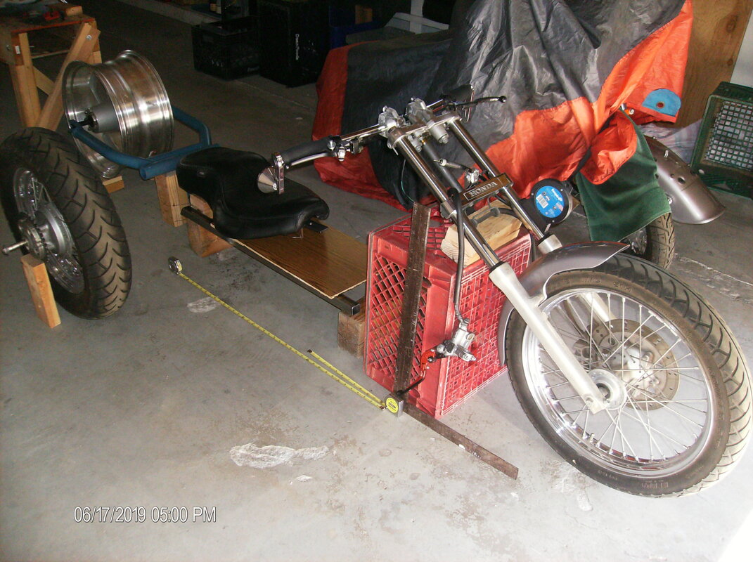

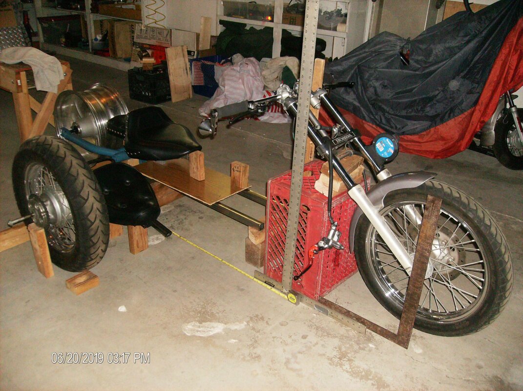

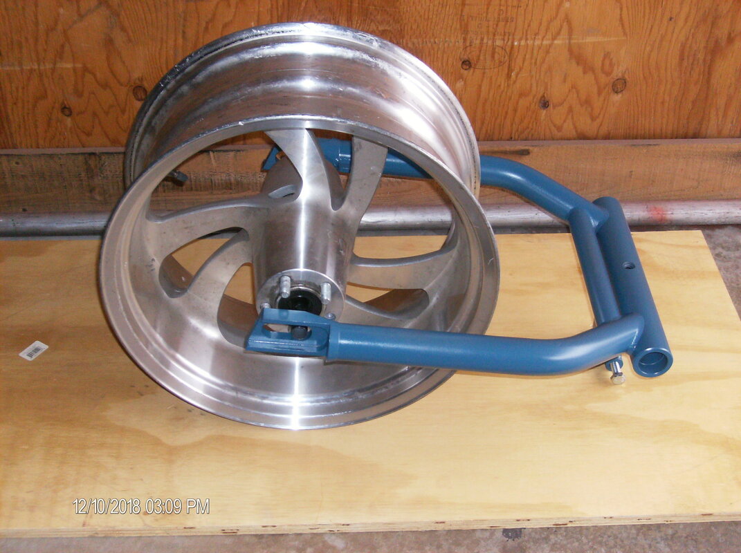

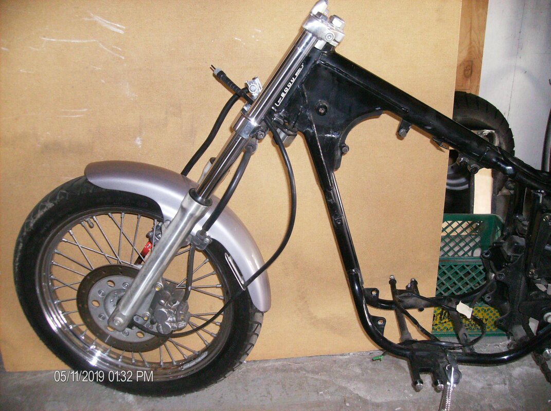

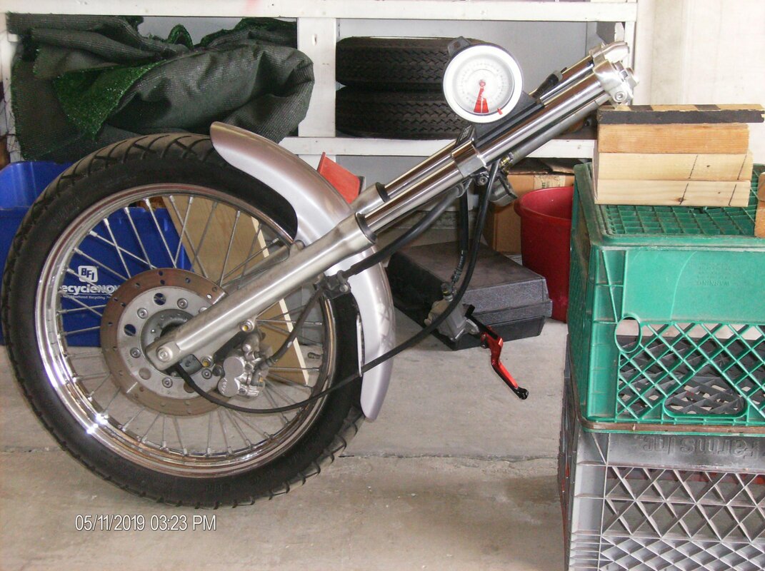

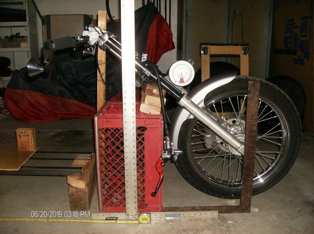

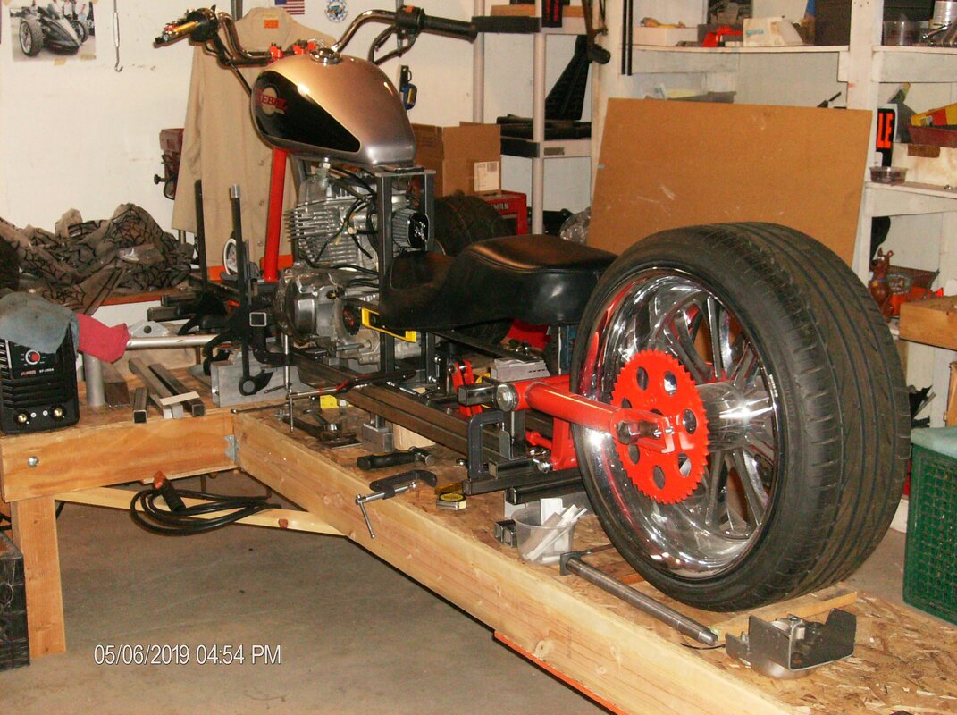

Front fork angle 35 degrees is the first one, HPIM3498.jpgHPIM3495.jpgHPIM3497.jpg30 degree scares me... I am thinking custom frame, front engine between legs for air cool BUTTT! Bucket seats, Maybe I'll use this rear tire set up since It is laying around?1a- Wheel set-8x18.jpgHPIM3460.JPGShould look something like the rear tire on RebelRouser. I love comments, :clapping:

Front fork angle 35 degrees is the first one, View attachment 71493View attachment 71494View attachment 7149530 degree scares me... I am thinking custom frame, front engine between legs for air cool BUTTT! Bucket seats, Maybe I'll use this rear wheel set up since It is laying around?View attachment 71496View attachment 71497Should look something like the rear tire on RebelRouser. I love comments, :clapping:

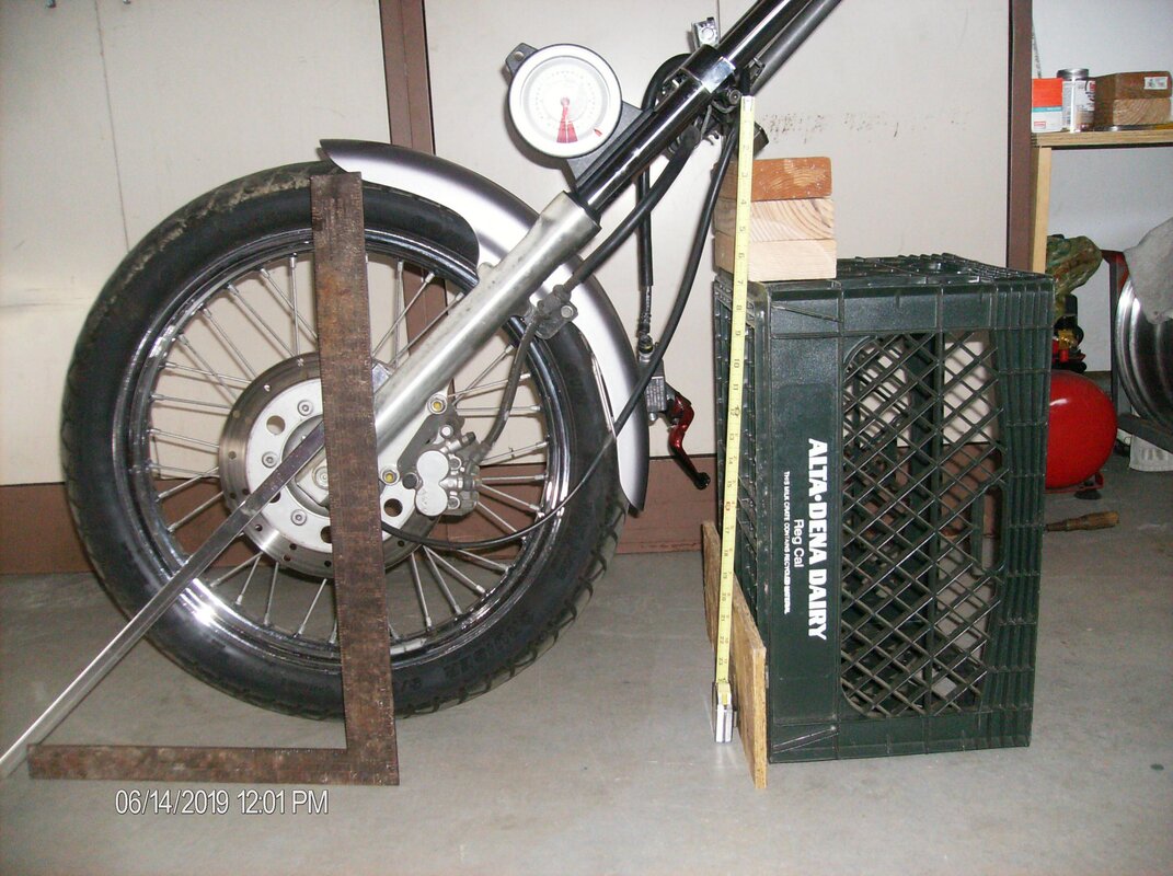

30 degrees is a lot. Consider the frame of all the touring bikes is rake a 26 degree. For the trike HD adds a tree with 6 degrees rake added . If you were to add 30 degrees to the frame 26 you really out there. And you will need longer tubes.
To give you an example: Stock frame 2017 RGU rake is 26 degrees added 6 degrees. When you add rake the front end drops. Stresses the neck and tubes. Adding The trike tubes that are 1 3/4 inches longer brought the bike back to proper front end height. Over all the rake and tubes increased wheel base 4 inches.

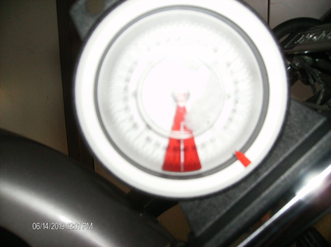

Neck Angle

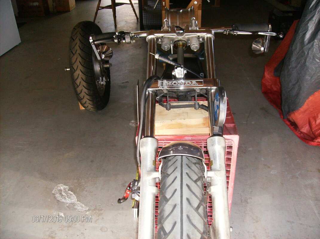

HPIM3561.jpgHPIM3560.JPG 45 degrees, wood is 6" or bottom of frame (ride height) Neck frame is measured from bottom neck bearing. Now we are talking bucket seat! Where will the handle bars be? Looks like I need to do a mock up with 35 degrees and one of my extra handle bars...:confused:

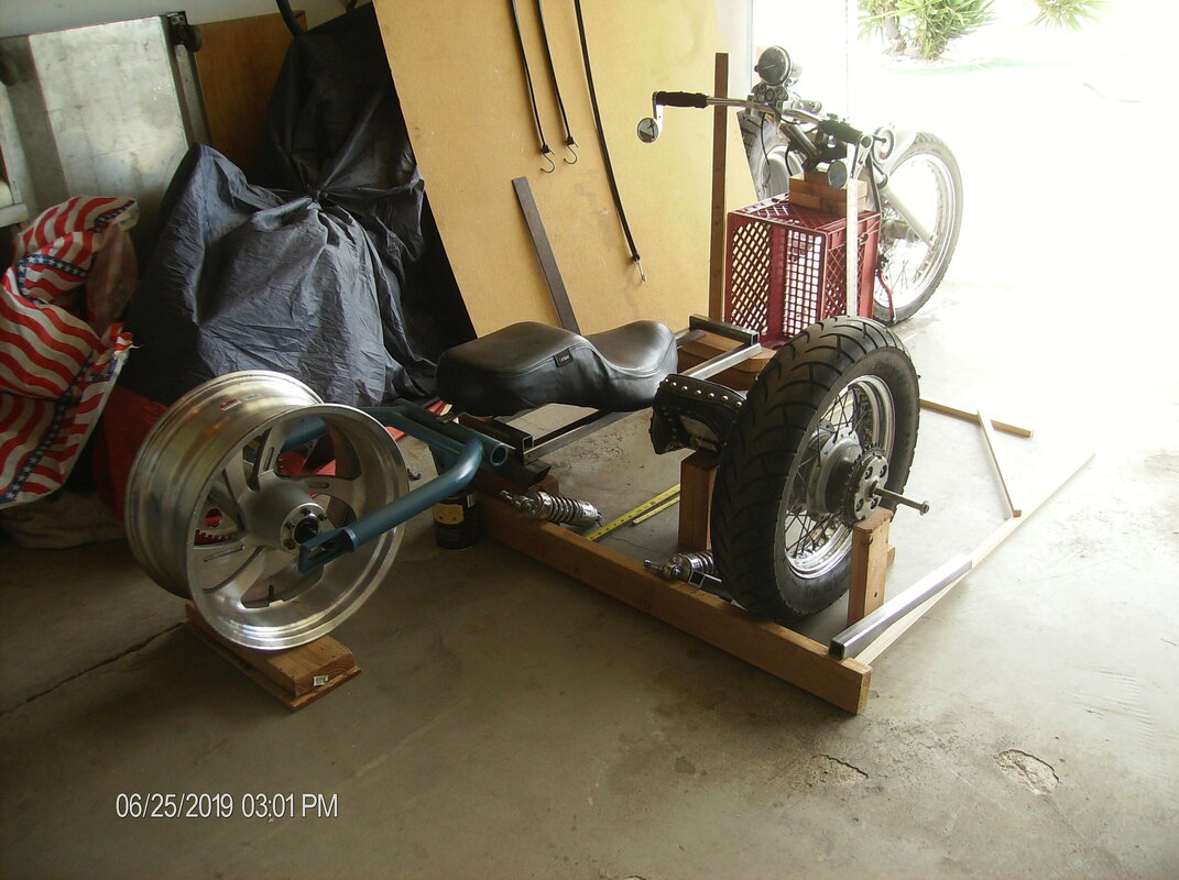

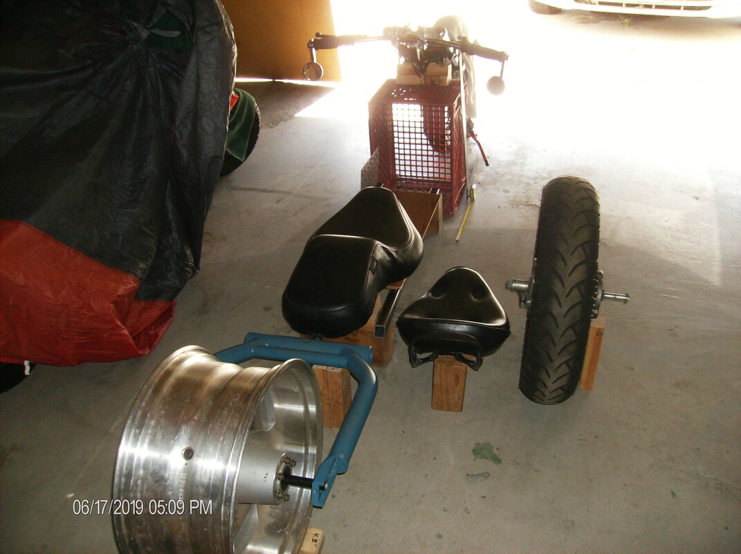

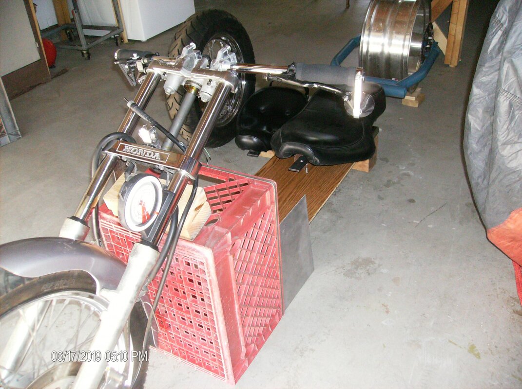

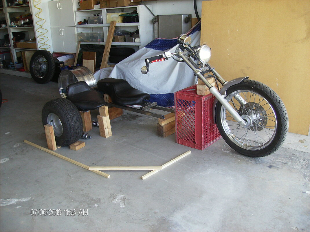

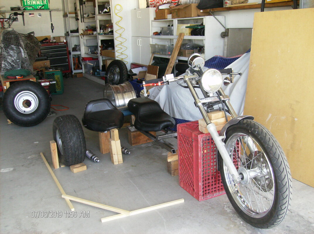

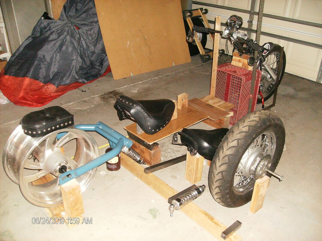

OK guys, What do you think of this layout?HPIM3565.JPGHPIM3566.JPGHPIM3568.JPGHPIM3570.jpg WB 7'6" H30" W36" 2 Bucket seat and pull back handle bars...Edit: Forks are at 35 degree here, Bucket seats will be about 20" W
As it sits the forks are really stretched out. That concerns me. the third wheel is a bit close it may work. I need to do some serious thinking on that. to form an opinion.

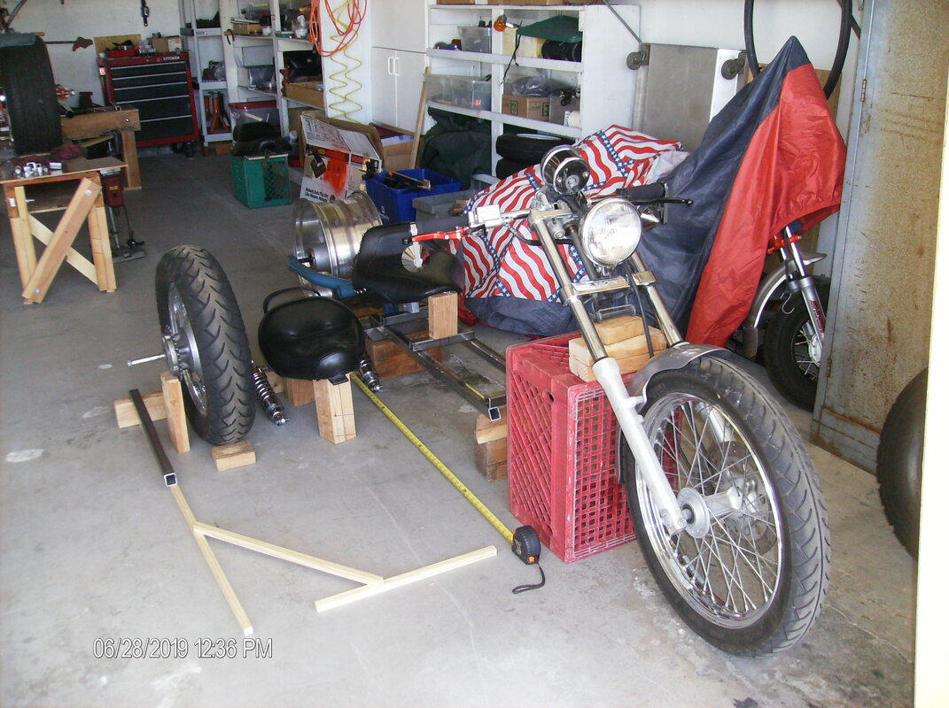

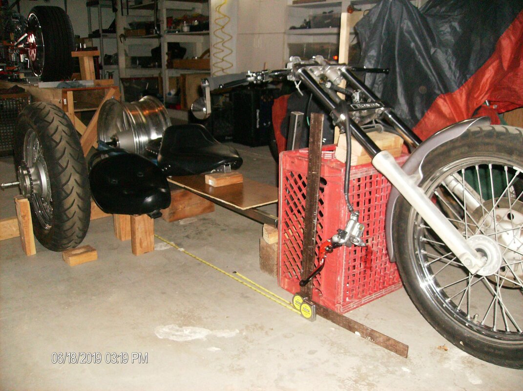

HPIM3593.jpgForks at 40 degrees, more height at the gas tank area. HPIM3592.jpg Looking at rear flat tires soon...Edit: First of all this must be registered as a home built motorcycle, RIGHT??? With flat tires rear and side???

HPIM3592.jpgFork angle is 40 degrees here a little more room for the gas tank, and with the RebelRouser build the lower frame at 9" wide the stock Honda exhaust worked out great looking at 42"W...
