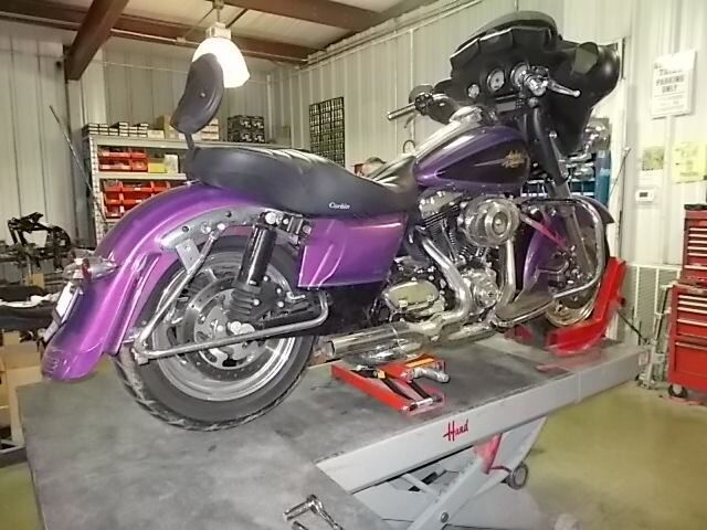

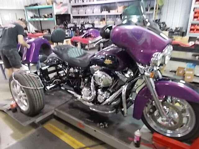

Our Street Glide leaving for Kentucky,yesterday.

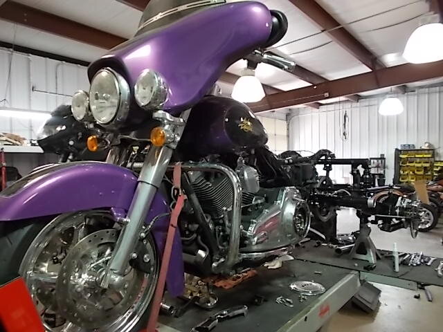

On the lift for teardown. The transformation begins!

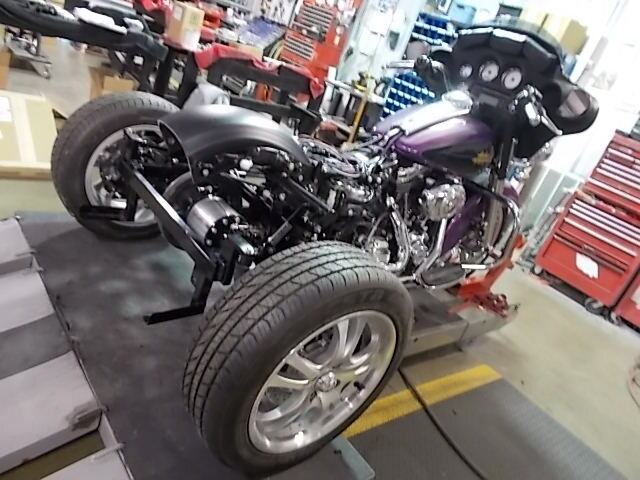

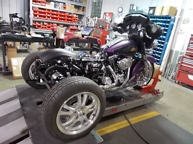

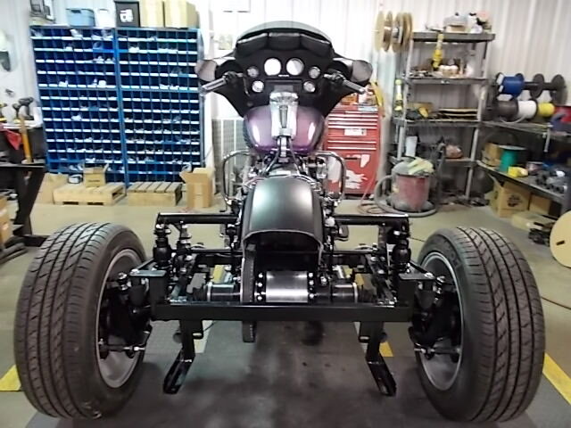

Installed the trike frame and rear drive assembly. A true work of art!
Fully independent trailing arm suspension, dual disc brakes and huge shock travel will make this beauty a Caddy to drive!

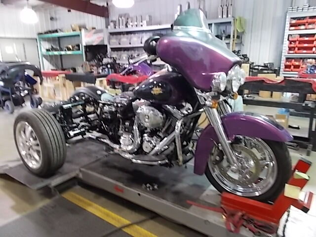

The kit is together and bolted in place, now to get the belt on the pulley and align the rear end and adjust the belt tension, check alignment and tighten everything down.
Next the transmission cover comes off and the Champion reverse gets installed. This is a fairly involved process that is not done quickly.
The base kit is completed, new fiberglass stub fender is installed, as the seat bolts to this. Its starting to look more like a trike.

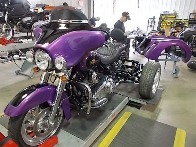

Next the stainless brake lines are run, and the brakes are filled and bled. Everything is tightened up, witness marked, reverse is installed and now it will be rolled off on to the floor and the rear wheels will be aligned.
Wheels are aligned everything double checked and then its time to build and install the wiring harness and check the tail lights, brake and turn signals and then the body mounts go on. Next that beautiful body get lifted into place, aligned and set.

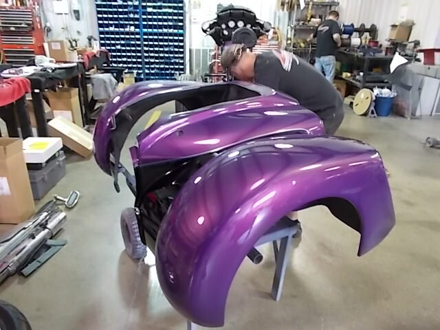

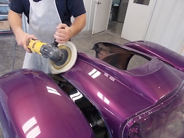

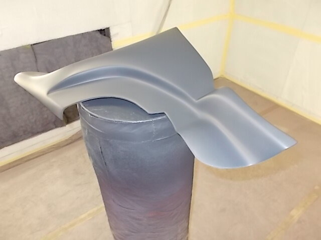

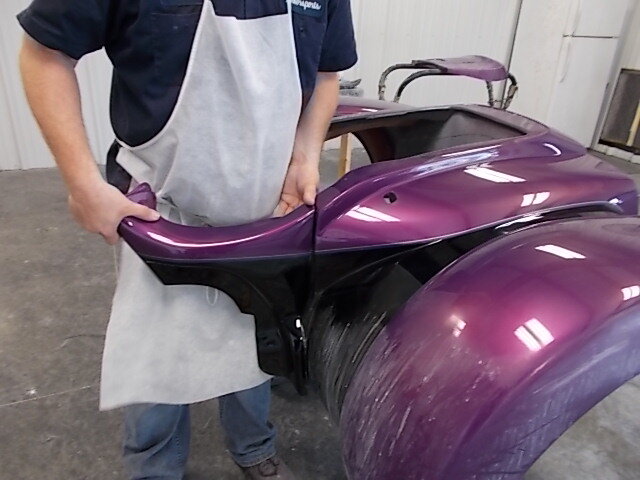

The body is being prepped sanded, sealed and painted at the same time the kit is being installed.

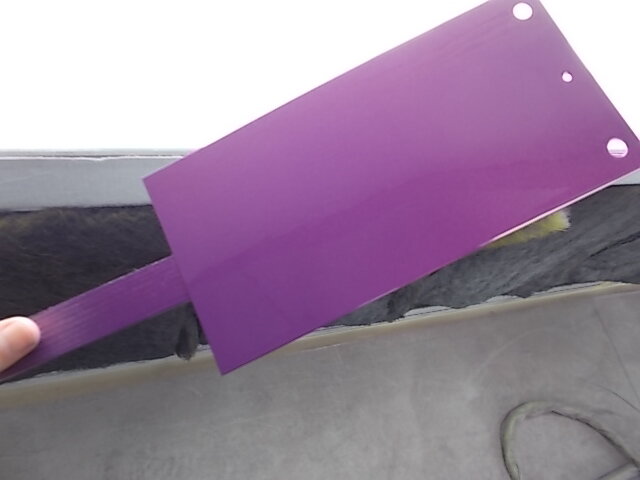

First, the test panels are sprayed with multiple coats until exact color match and pearl flop match is achieved. Hannigan has real talent and pride in their paint staff. Tim is the guy doing the painting and he is good.

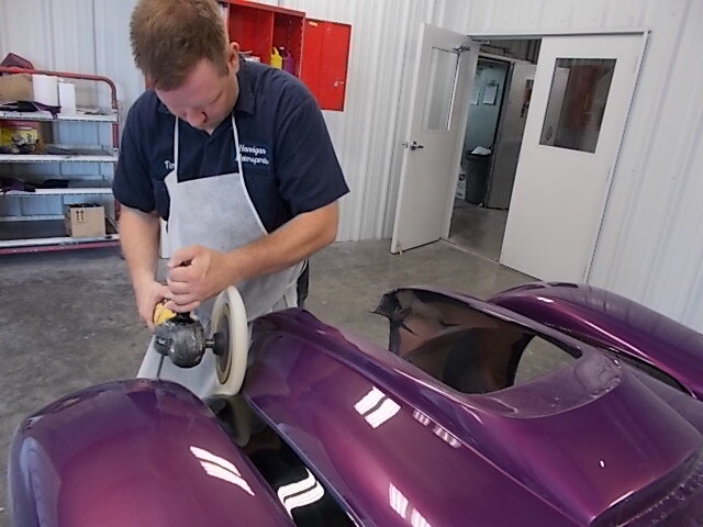

Smooth as a baby's butt!

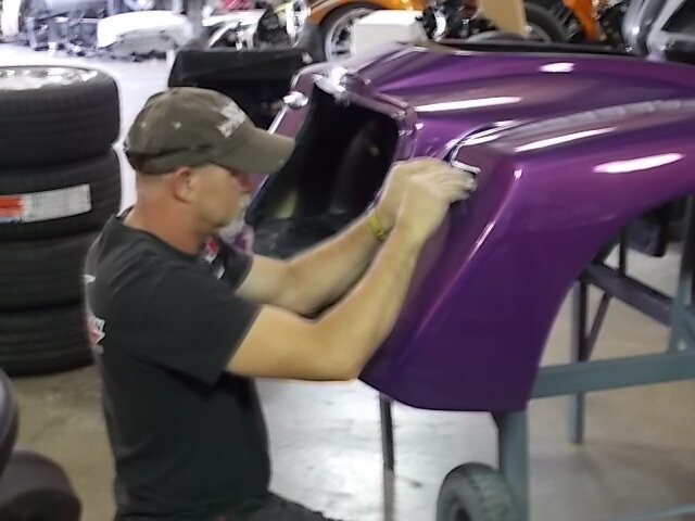

The man himself, Jim Gooch installing the tail lights in that beautiful bagger body. This guy does it all from prototype design and fabrication to dealer install training, to warranty administration, a man of many talents. If you ever call with technical or warranty questions, this is the guy you will talk to.

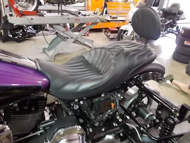

The Corbin Custom seat with driver and passenger back rest that Clint chose is just the ticket for this bike. I will be adding the same seat to my Hannigan Transformer trike. The man has good/expensive taste and is a perfectionist just like me.
