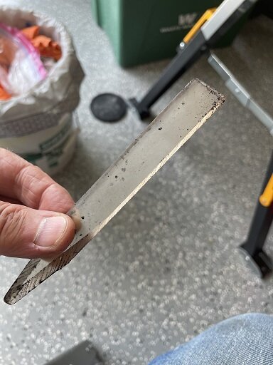

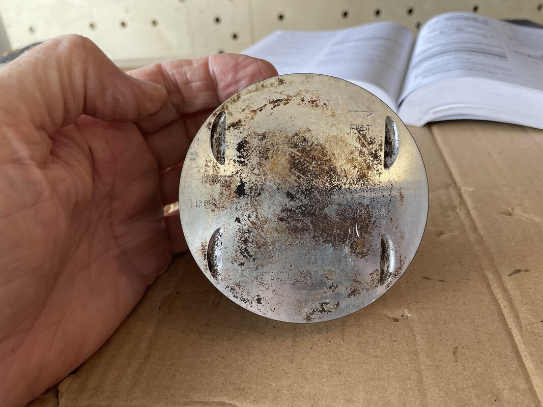

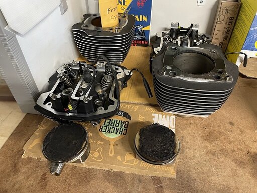

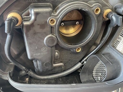

When I bought my 2019 Electra Glide Standard, I had no intention of running external breathers.
I have always kept the oil on the lower half of the dipstick (I have never been one to constantly worry about oil level, in my opinion if it shows up on the stick you have enough).
But during an unplanned teardown at 15,000 miles I saw that the tops of both pistons were encrusted in carbon, so much in fact that I could not see the arrow that shows which way is front on the piston.
I scraped the crud off with a plastic scraper.
I routed the breather hose out of the air cleaner and routed it overboard.
The way the OEM breather hoses are configured in the air cleaner, I think the engine actually sucks some of the oil into the throttle body.
Since rerouting the breather I have not seen so much as a drop on the end of the breather hose.
When the warranty runs out on my `22 Tri Glide, I will reroute its breather also.

your pictures and testimonial are awesome teaching tools for those wondering about external breathers. If you don't mind saying what was the unplanned tear down all about? Greg

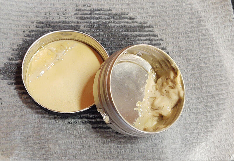

Here's a pic of what was in my home made catch can after 125 miles. Glad it's not going into my motor.
That stuff forms in the overflow catch can.
After the hot vapor cools off, the moisture in the air condenses and causes that mess.
With the OEM breather hot vapor goes into the engine, not the outside moisture, so that stuff won`t form inside the engine.
When the oil filler caps were the vent for the crankcase on some car engines, that goo would be all over the openings on the bottom of the filler cap during winter.

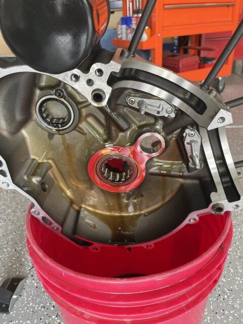

When the bike warranty ran out I decided to install the latest version of the M8 oil pump (my bike was one of the last to get the old pump).
While I was in there I installed new lifters (Johnson Hy-Lift) and S&S lifter guides.
I decided to replace the inner cam bearing, it broke during removal, so I split the cases to make sure there was no debris in there (it was clean).
