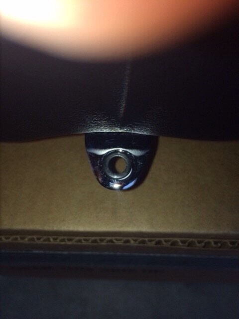

Harley uses the same seat tab on the Freewheeler seats as the rest of there Harleys . This is a mistake on the Freewheeler as the 1/4 X 20 seat bolt is under sized in the seat tab. This is because there in no centering insert like like the one that's molded into the two wheeled bikes threaded fender insert. This causes the seat tab to have a bit of play side to side and back in fourth (makes it hard to get seat bolt in same place every time).
The quick fix is a the 1/4 washer that comes on the handle bar control housing bolt. It is the perfect size to fit in the seat tab hole and make it the rite size which is a 1/4 inch. This centers everything up.
If you put the washer on your seat bolt and go slow the washer will press right into place and stay, perfect pressed fit. ( I had extras control housing bolts because I changed the control housing bolts to chrome )
Also new Harley Sundowner seat installed with washer mod.
Ride Safe All, :)
Bill G

The threads are not the problem and my seat fits like a glove too. The issue is the hole in the seat tab should be 1/4" to match the diameter of the seat bolt which is 1/4". That is why I pressed the perfect sized washer that came off the control housing bolt in the hole to take up the gap.
Look at the pic and you will see the washer pressed into the oversized hole in the seat tab. Now the seat tab is 1/4" in diameter just like the 1/4 X 20 seat bolt.

Yes a little adaption was needed... I don't care for the way Harley did the seat tab set up on the Freewheeler. The seat tab should have been drilled 1/4" to match the 1/4" threaded seat attachment bolt. ( No play at all this way)
With my simple mod as listed all is fine and good now. The Seat fits perfect, there is no side to side or back and fourth play in the tab now. Everything bolts down in the exact same place every time now.

I think your still missing my point here.
My seat tightened down tight and did not rock with the bolt tight from the get go, this was never an issue. The issue and problem for me again is the hole in the seat touge is over sized and bigger around than the seat bolt that goes through it. I did not like this at all so the mod I did made the over sized seat touge hole the correct size for the 1/4" bolt that tightens down the seat to the frame. Every single Freewheeler that I have seen has been this way. About 15 of them so far and counting.
I still bet you a dollar to a donut the hole in your seat touge is oversized and bigger around than the 1/4" seat bolt.
Even though the seat bolts down tight and works it is not right. Harley needs to correct this, my mod makes it right so the hole in the seat touge matches the seat bolts diameter.

My Seat fits perfect into the recess and tightened down with no problems or rocking from the get go.
I just did not like the oversized hole issue in the seat touge compared to the 1/4" seat bolts size as stated.
I did talk to Harley Corp about this issue I and the guy I chatted with looked at the PDF file and micro film on it. Then he said they will look into it and was sending off an e- mail to the engineers as we spoke. Then he said they may have missed something. Then he said if they did miss something it would more than likely be fixed on the 2016 models. He agreed at a glance the seat touge hole should have been a 1/4" in diameter to match the bolt size or a proper fitting washer should have been included to take up the spacing.
The Question is? Will Harley change it and make it right or just live with it because it works and most folks don't notice it or think there is an issue because it works the way it is.

After getting over my lazy streak I checked again, but paying attention to the mount female mount screw set. It is fixed not like other HD's are with a snap in set screw. So I did this.
I drilled the hole slightly saller than the screw so it would screw on it and stay. This way when I remove the screw it stays intact. Don't have to keep up wit it that way. It's just a plastic spacer you can get at most hardware stores. I keep em to make saddle bag mounts.

I Love it... ( plastic nylon washer sized to fit ThumbUp) Pretty much the same outcome as what I did with the little washer mod in my pic,s. Ya Harley missed this little issue for sure. I am glad it's pretty much an easy fix if your willing to think outside the box a little.
