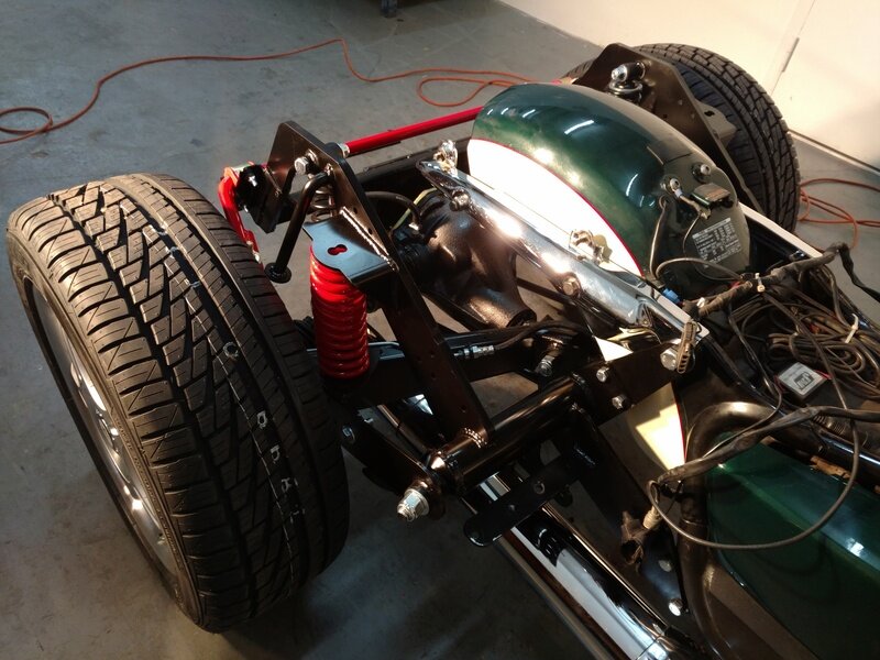

Kit in place, mounting brackets installed, now to bolt everything together with grade 8 bolts, nylock nuts or locktite on the smaller non-locking nuts, torque and witness mark all the bolts, hook up and bleed the brakes and install the 6 degree rake kit, tapered bearings and races. The bar shown above, serves two purposes. One, it is the receiver hitch for pulling a trailer and two, the crossbar provides the two rear mounting points for the body. Simple and well engineered.

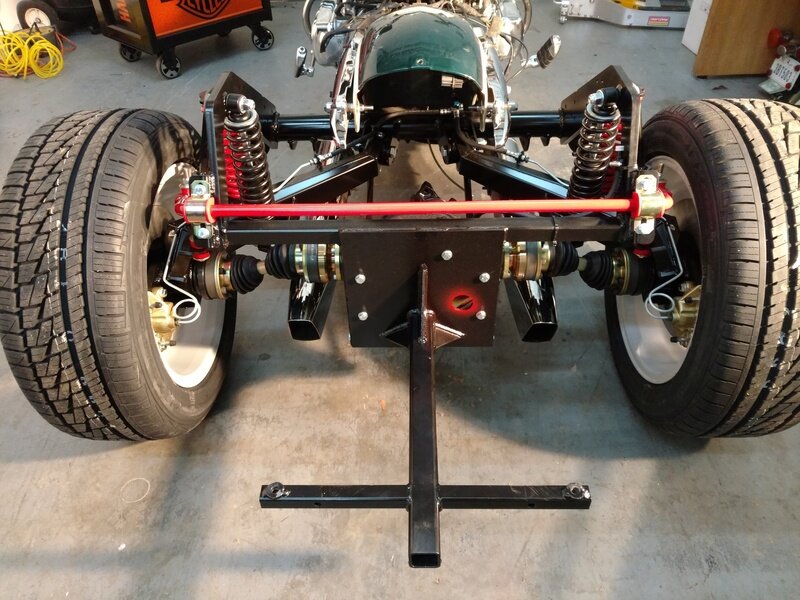

Shot of the conversion bolted in place. The Roadsmith IRS suspension is a clean, straightforward design and rides like a Caddy. Look at the thickness of the frame and the size of the sway bar, built like a tank! Also the attention to detail, like the red powdercoated springs, crossmember and swaybar are a very classy touch.

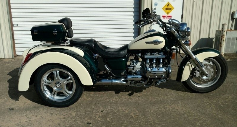

After the body and trunk is installed. Looking good!
Elliot wanted to add a tour box, where before it had just a backrest. I found a real nice local Harley chopped tour box off a CVO Road Glide and sent it to Roadsmith with instructions on how we wanted the paint laid out and this was the result. We like to always be unique on our paint job layouts and this one was no exception.... We don't do ugly.
Roadsmith built a custom stainless mount for the tour box to attach to attach to the Valk frame via a set of interstate side brackets I found on eBay and fitment was perfect. I think it turned out really nice.
