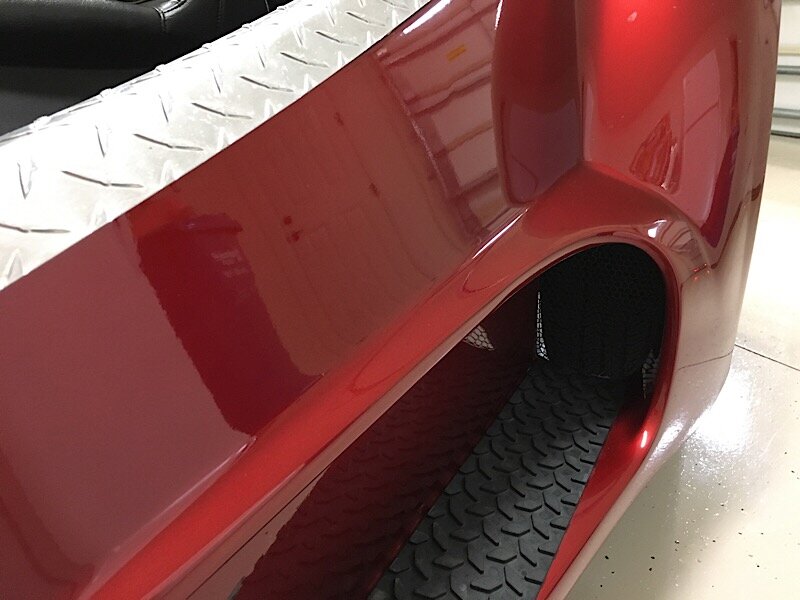

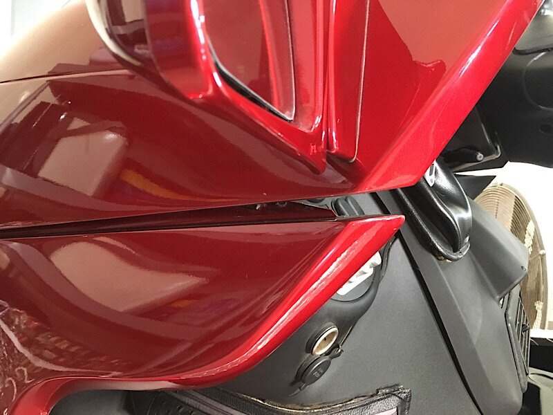

My hood has a gap on both sides. I have removed all rubber stops front and rear and also removed the 2 locking mechanisms and the hood will not lay flat. I assume there is an adjustment up front, but I’m not clear on what needs adjusted. I see no sign of any previous damage.

I just got it and that is the way it was. No wrench in the way. I think it's ABS and not fiberglass, 494. It will lock in place when closed with no problem, it just doesn't look right. There is no damage or bent linkage up front, everything looks good.
The front hinge with the hood open you should see 2 bolts on each side. And those will effect how it adjusts also. If you do mess with these, mark your hinge location with tape so you can use that as a guide . Your body will tell you plastic or fiberglass. Look on the side, fiberglass will be smooth and plastic will have a seam even to the back of the front seat.. Adjusting the hood is a LOT of trial and error so have patience! Tomg
Thanks Tom, but you lost me on the fiberglass/plastic comment and seam to the back of the front seat. Are you talking about the exterior? Here’s a pic if it helps..

The coolant tank is not near the shocks, I’m taking off hoods struts (shocks) to make sure they are not holding the hood from going down and mating with the lower part. Right now I have removed the coolant tank, hood locks and rubber stops next to the hood locks. The hood will still not set flush as seen in the pictures. It’s not hitting on anything I can see, so possibly the shocks are holding back the closure, may be the wrong size.
