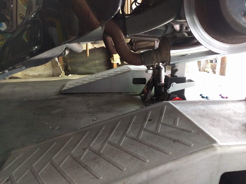

Im like you I use ramps for some of the maintenance but for brakes and pulling wheels I use hydraulic jack stands on the outer sides of the axle. In a pinch Ive jacked up under the pumpkin but the balance is always an issue and dangerous.

Thanks.... Your pic's look familiar..... LOL. It is a balancing act for sure when under the differential. I have my wife push down on one side or the other as I'm placing jack stands. Great to know that these axles can be jacked up on near the wheel. Thanks! Ray 👍

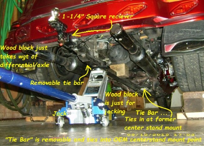

I had added a long piece under the rear axle that ran from hitch reciever to center stand mount lugs. It stiffened the rear frame too. With the block in place, it jacked it all up as one. Without the block, it let the axle drop. A trike is like a triangle tripod, so if I just needed one side up, I jacked under that side of the axle. If I was pulling wheels, I needed the axle to drop, so then I would jack and even put stands under the frame. I never crawled under there unless the tires were over ramps or the trike on stands.
That's pretty awesome! Making everything solid makes great sense! You certainly found a way of of relieving the stress points. In regards to Jack stands and ramps, they're a must in my world as well. Great job!! Ray 👍
