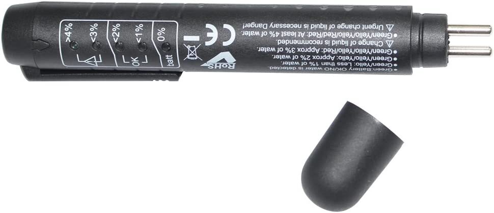

I would test the clutch fluid to see how much moisture is in there and if it is above 2% you may have found your issue.
Get one of these:
https://www.amazon.com/gp/product/B076SC377J/ref=ppx_yo_dt_b_search_asin_title?ie=UTF8&psc=1
Does this work with clutch fluid as well as brake fluid?
Yes it is the same fluid in both systems. Most likely DOT 4 but check on the cover of the master cylinder(s). It should say what type fluid is required.
Yes it will work on all brake fluid
Keep in mind when you do a fluid change, only buy as much fluid as you need. Once you open the bottle the clock is ticking.
This means moisture is entering the fluid, so use it all up, do not keep it on the shelf for any extended period of time. You will thank your self for this
