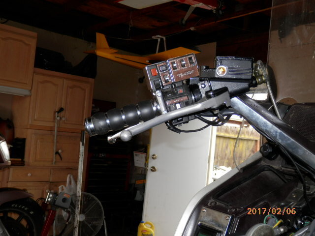

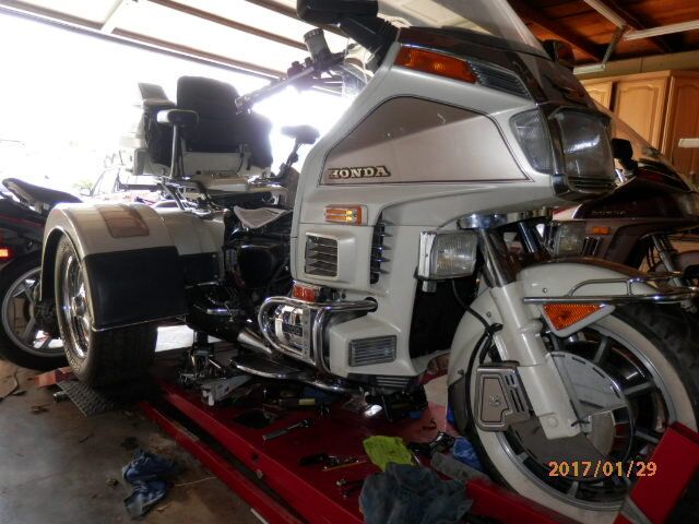

So here is what I have done so far, I am still sorting out the master cylinder, I can't quite get enough throw yet using a gl1000 master at the moment 11/16 bore, I m trying to locate a 3/4" bore for 7/8" bars with enough throw to get what I need done. I decided to keep the SEI for the project and sell the Aspencade.P1290012.JPGP1290016.JPG

Thanks for the information, I'll have to check into it. Using the 11/16 master piston bore size, I am right at the edge of it having enough throw. The manufacturer of the slave cylinder recommends a 3/4" piston bore on a master cylinder but that pertains to an automotive master which probably has longer piston travel in the master cylinder and can push more fluid. I would still like to try a front motorcycle master with 3/4 bore, only one I have found is from the late 70's to early 80's dual disc Harley FLh and FL, with the narrow mounting perch, I can get a new one, but they are real pricey new, especially for something that I do not know if it is going to work, they are also for the 1" bars, not a real problem that a sleeve wouldn't take care of. Going to include a picture of my back up thumb brake set up it just operates the LF rotor.
Thanks for the information, I'll have to check into it. Using the 11/16 master piston bore size, I am right at the edge of it having enough throw. The manufacturer of the slave cylinder recommends a 3/4" piston bore on a master cylinder but that pertains to an automotive master which probably has longer piston travel in the master cylinder and can push more fluid. I would still like to try a front motorcycle master with 3/4 bore, only one I have found is from the late 70's to early 80's dual disc Harley FLh and FL, with the narrow mounting perch, I can get a new one, but they are real pricey new, especially for something that I do not know if it is going to work, they are also for the 1" bars, not a real problem that a sleeve wouldn't take care of. Going to include a picture of my back up thumb brake set up it just operates the LF rotor.[/QUOTE]
Found the 3/4" master cylinder, what a difference between the 11/16" after adjusting the rear brakes up, I do believe my setup is going to work, the ultimate will be a test ride, I will keep you all up to date on the progress of this.
