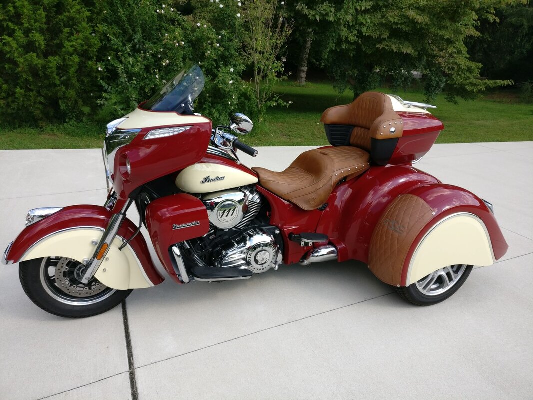

I'm in the process of converting my Roadmaster to a trike. Having some quality control problems. Will keep everyone updated. Been 4 weeks since they started it.
I'll be following closely. What kind of quality concerns? I've got to choose a direction soon for my Roadmaster. Would love to go Tilting Motor Works but the Roadmaster conversion they said they were working on must have stalled as I've yet to see it displayed ANYWHERE. So will be interested in any and all problems and their solution you run into. I assume if you are running into problems that means you are doing it yourself and not our fearless leader here?:Shrug:
3015 Roadmaster
I've done alot of research on the different trike kits. Everything and everyone told me that California Sidecar was the Best, to go with them. You have to have a factory trained mechanic to install them. Rocky Mountain Cycle is where I'm having it installed at' They have done bout 10 different kits. My problem is quality control, !. they sent the wrong break lines, 2. the reverse module was bad( they knew about the problem and still sent a bad one), 3.the reverse pulleys were out of round ( they knew about and sent bad one's ), 4. the lower pulley they sent was out of round Again. I will be talking with the CEO of the company about all their problems so far. 2 week behind finishing my trike. What do you think?
Two week delay isn't as bad as some I've heard of but you don't have a finished product yet either. I've heard of 3 month delays. Hope yours is better than that. The thing that bugs me about trikes is the finger pointing after if something is wrong. It's never the bikes problem and never the kits problem. :mad:
Long wait
Well I must agree with you. It"s never the kit problem, no admitting to it, that's it's their fault. Well now they DID. Finally sent a good set of pulleys, they worked!!. What I don't believe is they are going to give me a Lifetime Warranty on the reverse, everything, pulleys, belt everything. But seeing is believing. Now my mechanic can try and finish it. Looking forward to riding soon.:clapping:
Finished !!
Well they finally finished my trike. After my side manager and staff got together with CSC staff and worked out the problems. Looks Great!! Will post photos soon. CEO didn't remenber that he gave me a LifeTime warranty for the reverse pulleys, belt, module, etc. My team had to remind him and he finally admitted he would give me that warranty. Going to enter my bike in a bike show next month, that's how much I like it.
