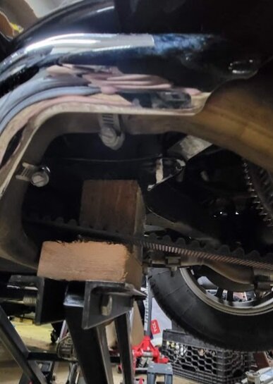

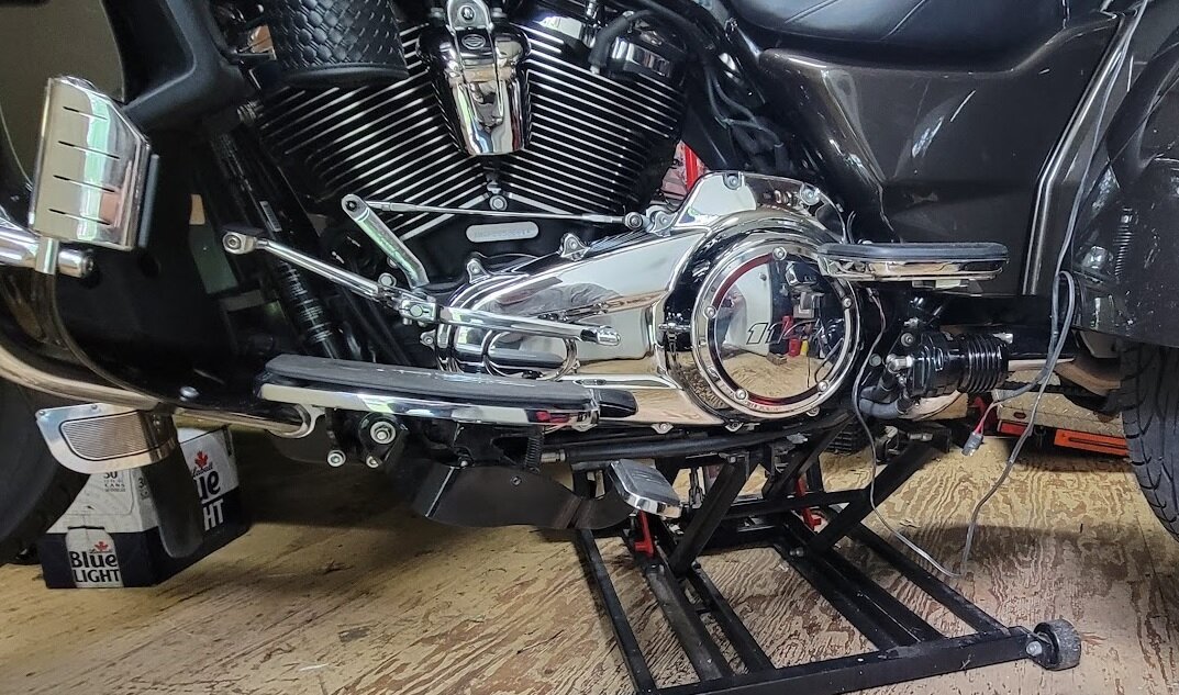

I just made a wooden spacer to mimic the J&S piece. Seems to work well.
One note. It's a bit wobbly till it gets higher. To be expected since the arms are all the way out. As it goes up the center of gravity moves towards the center of the lift making it much more stable. I just use it to get my jack stands under it.
View attachment 114161View attachment 114162View attachment 114163
Thanks for the photos - it appears to be a 2x4 and a 4x4? I had considered doing this but I was unsure as to the spacing needed. I notice also that your support bar is 2 pieces of angle iron giving the lift skid/bar a wider base. I can change out mine.

It's actually a 3x4 and a 2x4. I used the 2x4 to spread the load across the lift arm.
Anyway to get the measurement I raised the lift to just make contact with the frame. Then measure from the lift to the cross brace of the frame. I think it was about 5 1/4". Kinda tuff cause you have to lay down and reach under the trike, but you get the idea.
