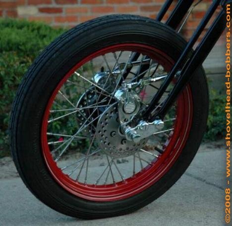

I've gotten an adjustable proportioning valve for my linked brakes to make the front caliper less effective. It's too strong and will lock the front up before the rears grab. It is improving the brakes.
My crude floaters work well now that I have proper reaction struts built. I was breaking them. Then I went to 4130 moly tubes and heim joints. No problems since. And the braking is very neutral -- no real rise or drop on the front end under braking.

The nutshell is that you have an axial caliper and I have a radial. The mounts are completely different. The description of what I did is posted earlier in this topic. The essentials are the same, although the mounting considerations are different. You have the right start -- deciding where the caliper needs to be. Now you need a flat plate to act as a mount. It needs to have a bushing or bearing that fits over your axle spacer.
The bushing needs a little play to slide on the axle as well as spin around it. This is because you have a fixed caliper. It has no centering capabilities of its own, so any little deviations in alignment must be compensated for by moving the mount on the axle rather than moving the caliper on the mount. A single-sided floating caliper would simplify that part. If I had to do it again I'd use a SSFC instead of the dual-sided fixed caliper I've got now.

The bracket is part of the caliper assembly, bracket is mounted fixed and the caliper moves side to side, only one side has pistons.

One also has to check suspension travel of axle and how the caliper rides the rotor as the rotor moves forward and backwards with the suspension. (remember caliper is fixed to bracket that pivots around the axle )

My choice would be a bushing over a bearing, and I'd want something I could inject grease into (zirc?) in order to push out grit. I didn't install lubeable bushings in mine and the floaters stick sometimes. Keep in mind that I'm not an accomplished LL engineer. My experience is limited to the one I built.
Ball and roller bearings really want to go in a full circle rather than a few degrees to and fro. There's not enough travel on the floating brackets to use a roller or ball bearing -- they'll notch and grab like a swing arm or steering bearinng does when the ball/roller travels over the same few degrees .

Looking at the picture of your set up I see one thing that causes concern. The caliper bracket anti rotation link looks a little light.
Consider the lever arm that exists between the axle pivot point and the caliper pads and the axle pivot point and the anti rotation link mounting point. What amount of rotational force do you expect to be applied to these lever arms under panic braking situations? Consider forward weight transfer during a panic stop when figuring the force applied before tire lock up occurs (maximum brake lever arm forces).
My concern is what is the maximum tension force for the threads in the material at the diameter you have selected for the anti rotation link?
