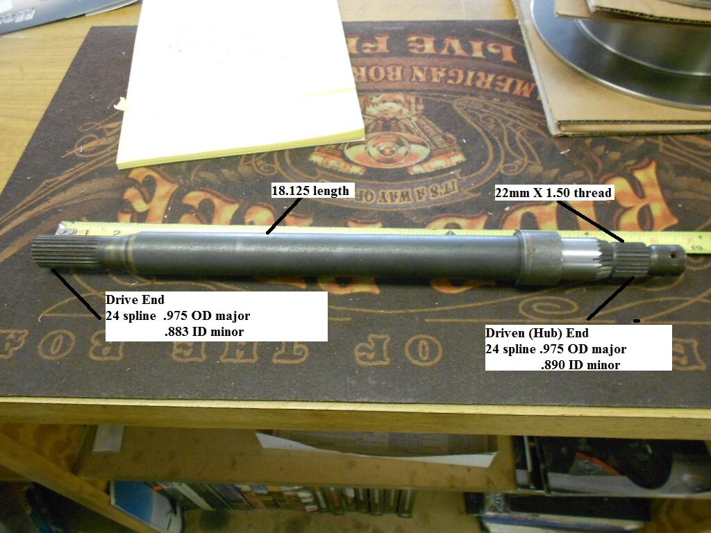

Do you have an axle length from tip to tip ?

Axel nut was loose,not sure why it was loose. Splines on end of axle very worn. Splines in hub are worn. The part that is pressed on the axle that the bearing sets against wore down .25 of a inch. I had a .25 inch spacer made and put it all back together with loctite 660. I would feel much better replacing the parts. I was able to find the bearing.
Sent an email to my contact at NAG, hope he will respond. I do have a NAG axle in hand, but I am reluctant to sell it before I have a source, or drawing, to make another one. I will contact you with whatever I find.
