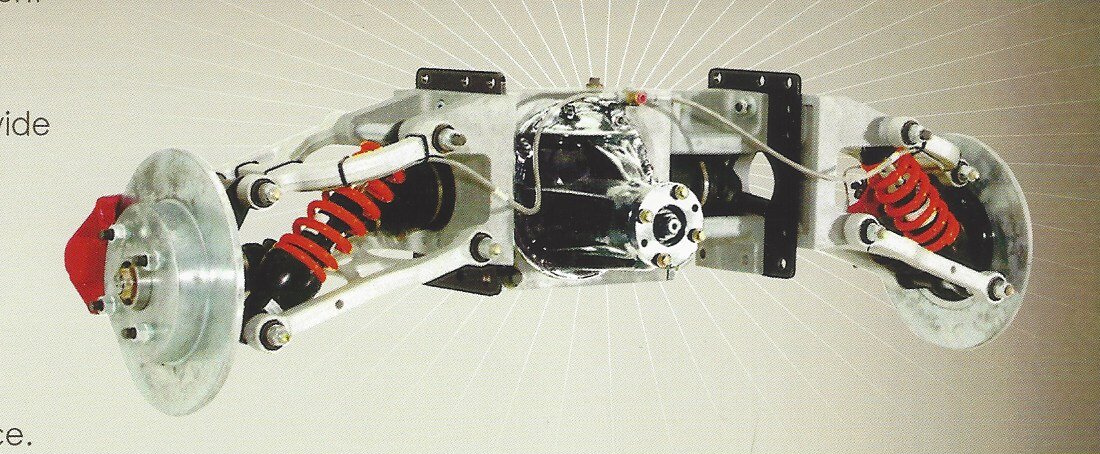

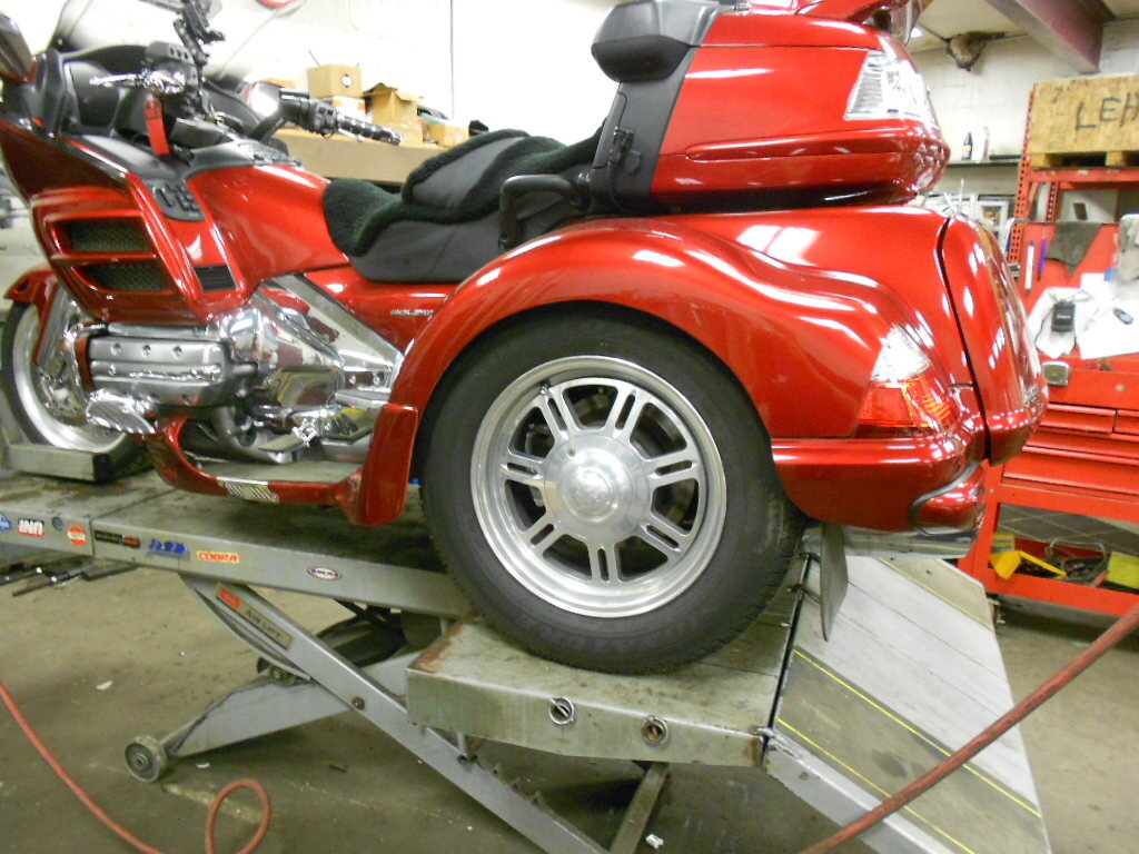

Hi- I'm new to forum and requesting any help or info on my problem- I have a 2013 Goldwing with a Lehmans Monarch II conversion-With 2 up at 340 lbs. the mufflers have 3 and 3/8 inch road clearance- the mufflers have met the road to many times- the trailer hitch when installed has 2 and 7/8 inch road clearance ,without a trailer and it to has done the same thing- I have compared the measurements with other trikes company's and the measurements on mine are 2 and 1/2 to 3 inches lower- I have turned the shock adjustment out I more turn to 5 turns out- any more adjustment and the ride is too stiff- I contact lehmans (Bill) and he said he would look into the issue and no reply after a week- Is there a shock extender that would take care of the problem or any other solution ---Thanks for any info---Hank

Hank, Welcome to Trike Talk Forum from West Virginia. Do you have the straight axle or the LLS ?

The trike is a LLS (independent suspension) A arms replaced at 12k and bike has 41k on it now

I contacted Lehmans yesterday to follow up on the problem of (Low Riding Trike) I requested over a week ago-there answer was- there is no problem and that's the way it's designed- I think for me it's a problem- scraping tail pipes , scraping hitch , and very hard to load in my toy hauler problems (with one of the lowest ramp of toy haulers)----I road on a friends bike(same year) for 500 miles (CSC) and didn't notice any scraping of any kind and the ride was noticeably better- it was smother a held the curves very well -With 6 lbs. higher tire pressure than mine ---THE SOLUTION- at this point I think we all know the solution for me is look for another trike and one of my choices wont be a Lehmans------

Good morning and thanks for the suggestions- When I purchased the trike it had 1900 miles on it in 2015 and I was told it was a factory install- It didn't have the body spacers and I installed them- the tire size is 205/70R15 by Dunlop an I did have a tire rubbing issue till I installed body spacers- I installed 1 in. fork tube extenders which brought the front suspension up- My measurement yesterday after turning shocks out to 5 turns are ,front of engine 3 5/8in. ,rear brace for floor boards 2 1/2in. ,mufflers rear 3in. ---I don't understand when a company advertises as being No.1 , the best, and whatever else they put on there adds can't follow up with consistent good products and SERVICE- When we pay $40,000 more or less for a new trike and have a multitude of issues to take care of- How about less money on adds and more on customers- After all that I do feel a lot better- Thanks for all the replies---
