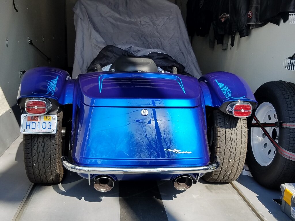

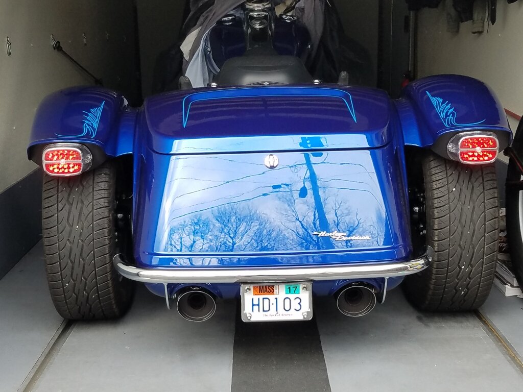

Here's a before & after of mine. I mounted a pc of alum 1"x 1" angle the length of my plate under my bumper using 3M two sided automotive tape. I then pop riveted 3 alum 3/8 rivets for a tight & secure install.I drilled holes in the bracket for the plate and frame before I mounted it. To light the plate I installed Custom Dynamic white tag LEDS, part # TBO1C.....$19.95 pr. I ran the wiring under the body to under the seat and tapped into the right side tailight. Good Luck!
