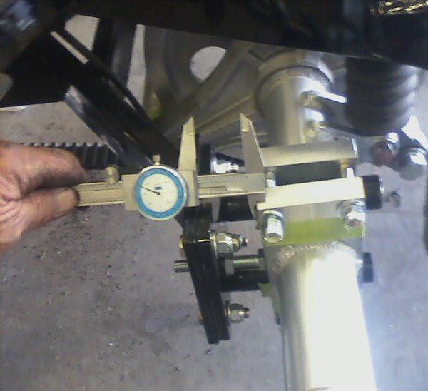

Mine is a champion straight axle but if you were to go to my build site I documented my assembly and it will give you some good pointers.
( click on a picture in there and will give you some text to read as well.
google-- pcombe library/photobucket
I hope it helps? ThumbUp
Belt adjustment
Axle alignment
d-8-usingadialcalipertoadjustalighnmentonaxleanddrivepulleys_zpsfd2f8067 (600 x 548) (2).jpg
