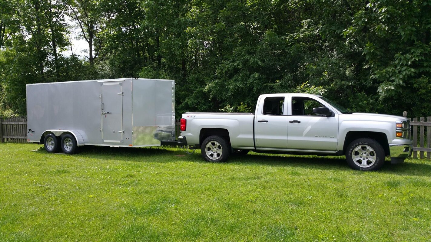

Have a 13 TriGlide. Went with a 7x16, w/ V-nose for almost 18' inside. Haul trike and Bushtec trailer w/room to spare. Store trike in it in winter. Able to haul friends toys. Going on vacation next month, without the Missus, but, bringing trike, close to where we grew up, have to bring MILs' furniture back. Waiting to use it when son gets married next year, to get his "stuff" outa here!!:D:pepper:(w/trailer, 1 trip. just truck multiple trips, 1 and done I say!) Like another poster put, figure your minimum requirement, go a step bigger if you could. Usually only about $100-$200 more.
