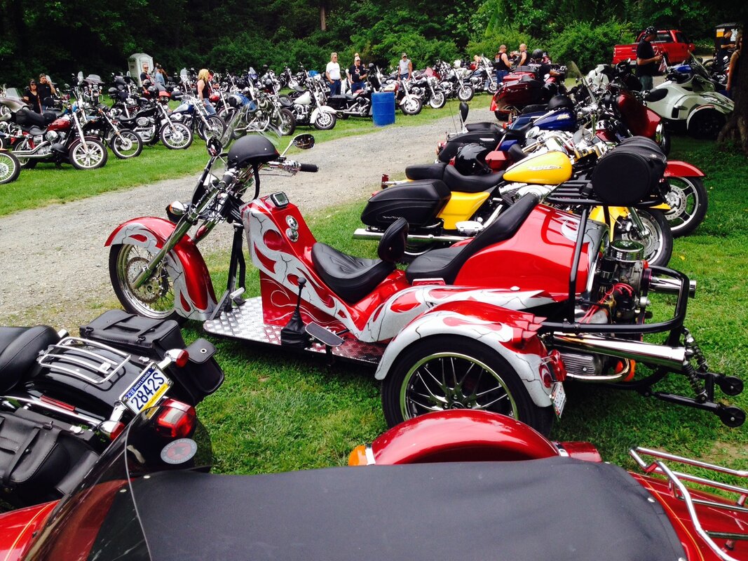

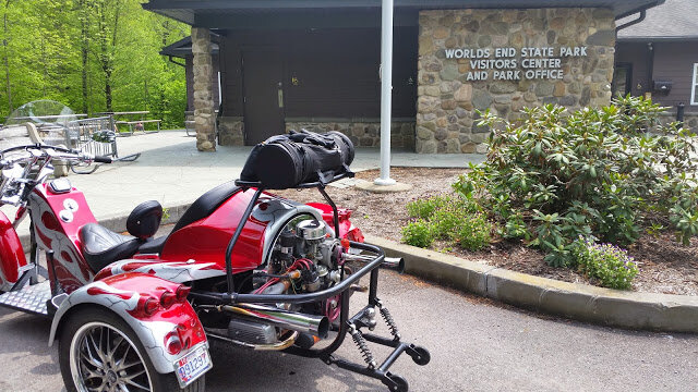

My 2012 VW Trike is killing me and leaving me stranded on the side of the highway and roads due to a short in my wiring. After trying to figure out why, I'm stumped on how to fix it. My back fender is vibrating so bad that it is literally pulling the wires out of the harness assembly inside the tail light. Which is causing me to have no tail light then eventually cause a short and hence leaving me stranded. I had a plate put in on the inside back where it connects but still way too much shaking going on in the fender.
Any suggestions?

As far as your fender issue goes, it is hard to tell from the pics you show.
I had initially set my trike up with rear fenders mounted to the rear swingarms. That was a major mistake, as there was way too much vibration passing through the fender brackets, ultimately causing them to fail.
I had to secure the fenders to the rear deck, where the vibration is almost nonexistent due to the deck being on the part of trike that is cushioned by the rear suspension.
If you can post a closeup shot of how the fenders are attached, perhaps a solution can evolve?
The tail light wiring can be always be extended if that is an ongoing issue.
However if the trike "dies" on the road due to a wiring issue, it is likely somewhere other than the rear tail lights but hard to tell without close examination of the wiring in general.
Any way to get a wiring diagram from the builder/previous owner?

Thanks for the info. I will take better pics tomorrow when the sun is shining. LOL I know it is from that fender because I have replaced the maltese cross light housing twice on that same side. It has been an issue for a while now. It's been rewired too. It's even ripping my tag apart. Each time I have taken off the lens, the light bulb and it's housing falls out into my hand and the wire comes out of the housing unit, and that's why it's shortening out. I've had to be towed the last time I got stuck on the side of 95, 125 miles from home at 10 pm on a Friday night. The worst part of that nite wasn't that I broke down, but not one person pulled over to see if I was ok even when I had to push it up the road. Sigh......

You state that you had a plate put in to attempt to stop the vibration. Did the plate get attached to anything or was it just put in to try and stop the movement?
If it's just one of the rear fenders, then there must be a stress crack in the fiberglass to cause this. If it wasn't a crack then both would be doing the same thing.

It is a California Custom Trike and as much as I love it, the guy that built it is a real asshole and won't even return any of my calls. I need some parts for it and he won't even reply. I have had nothing but trouble with them after they received their money. But one thing I did do, and that's download all the documents that his wife had sent me and I do have the wire schematics for my trike.
It's been rewired in the back already, the problem is the back fender is shaking so bad when I ride and of course all the pot holes that you try to miss and can't has pulled the wiring out of the bulb assembly and then that of course causes the short. I have replaced the brake housing twice but am still having issues. Like I said, I had a plate put in on the back of the fender but it still vibrates bad. And of course it's only on the one side. But thanks for your offer!
