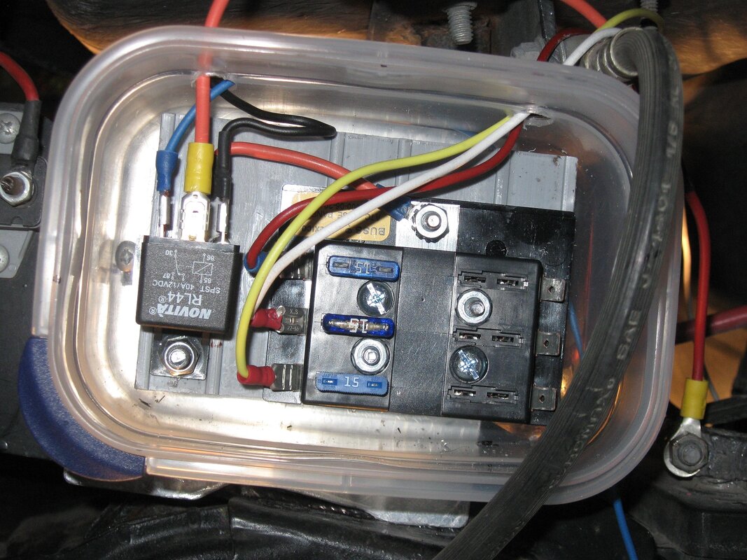

I did this on the Harley and the Goldwing trike. The relay and fuse block on both are mounted under the rear of the seat wherever I could get it to fit.
I didn't run the negative wires back to a central point, I just used a nearby frame bolt or screw to limit the wire runs.
Auto stores have the relay and fuse blocks in different sizes. I have the 6 fuse version in the picture below that is mounted under a fender of Gloria's Roadhawk VW trike in a box to keep the water away from the wires. All of these power taps are set to be hot only when the key is on. On all the bikes I have a direct to the battery always hot SAE type connector to use with a charger, and some adapters so I can plug in the cigarette style and coaxial power plugs.
Power distribution box without cover under fender of Roadhawk trikeIMG_0917 - Copy.JPG
It shouldn't be too hard to adapt and find a place to mount on your trike, The individual parts can be mounted wherever they fit on your ride.
