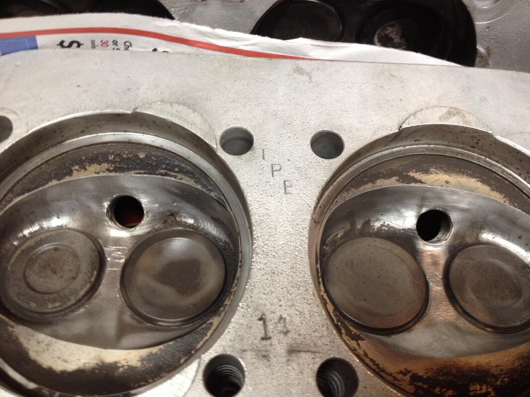

Welllllllllllllllllllllllllllllllll;) I went to buy some replacement valve springs but instead came home with two used replacement heads. Found a VW shop not so far from here in Mountain View CA that is helping me out. They need a minimal clean up to re install. So while I'm readying the heads and gettting ready to rebuild the carbs my ex mechanic friend comes by and though he is not yet a VW guru we were able to check and found the dreaded clunk and could see the crank end play moving too far as he said. So now I'm in the process of getting the motor out of the frame and off to the machine shop.....Here are some more pics. I did get the endoscope so you can see the top of the pistons thru the spark plug holes. Though I do see holes in the top of the pistons I think maybe they are supposed to be there? Very interesting so far.... And it's as if you fortune told the history of this motor as you'll see the debris in between the cylinders where there should have been just cooling air.....

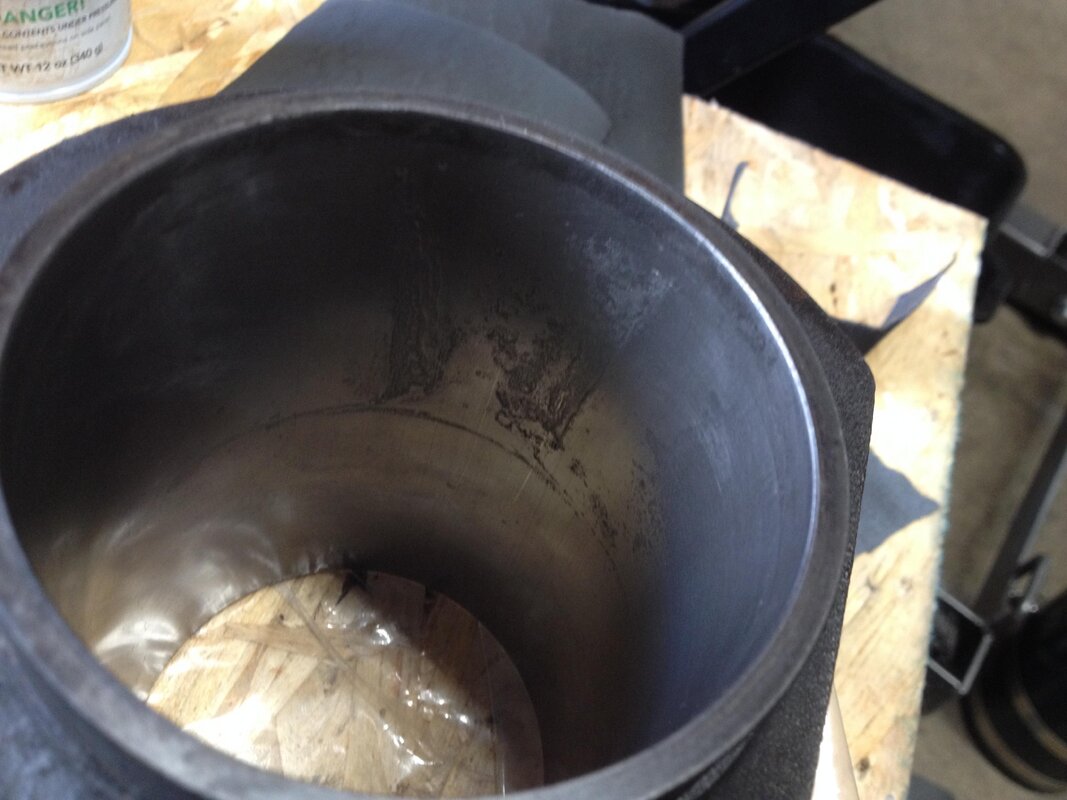

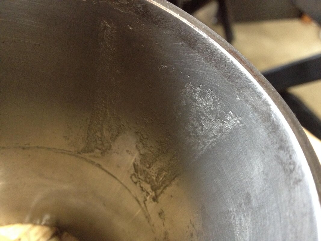

Check the sealing edge surfaces of the cylinders to the heads for signs of "blow by" usually dark stains in lines across the surfaces. This is a sign of loose heads. This is caused by 2 things: 1. Normal expansion / contraction of the heads and cylinders causing the head torque to loosen. Normally you would want to check and retorque the head studs every couple of years. 2. Head studs pulling out of the crankcase threaded holes due to age, metal fatigue, or over torquing of the head studs. Newer cases and a lot of reworked older cases will have "case savers" installed to eliminate this problem. Case savers are basically helicoils installed in the cases to spread out the load on the threads.
type1gasket.jpg An extreme example on left cylinder.
Check your heads very carefully for hairline cracks in the areas between the valve seats and the spark plug holes. Clean the area and use a magnifier. If there are cracks, the heads are unusable! This is becoming more and more common as the pool of original parts is getting older and older.

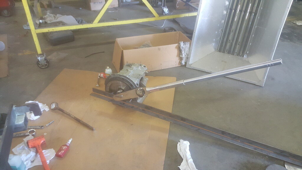

7. Remove the flywheel. You will need a flywheel lock tool and a 36mm 3/4" drive breaker bar for this. you will need some way to hold the engine as the Gland nut holding the flywheel has around 300 ft-lbs of torque. I have set the engine on the floor and slid it up under a car with 2x4 blocks to hold the engine from trying to roll over when removing and installing a flywheel. Be careful not to put ANY pressure on the head fins. THEY WILL BREAK!
8. Remove the fly wheel and seal. There are shims on the crankshaft that set the end play. Usually 3 shims. You can get shims in different thicknesses to adjust the end play as needed. Any VW engine builder will have a bunch of these. Follow the procedure in the service manual to set the end play then install the new seal. Reinstall the flywheel.

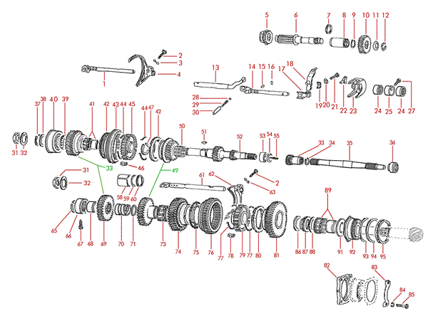

I forgot to mention when I first tried to separate the engine and trans it seems the pilot shaft was sliding out and thus it seemed like I needed more room as I was planing to lift the motor out of the frame. I didn't know that was happening so I re mounted the engine and had to take my rear frame apart so I could lower the engine out but when I did get it apart I discovered the pilot shaft would slide out a few inches? Is that normal? when it seemed like it was loose of any splines inside it would bump up against something so I did not try to remove it, and it seemed to go back in just fine.....
Anyone else run into this?
pilot shaft movement
Circlip #34 has come off. This is not unusual in older transaxles. The reverse gear (#33) is captive in the case. You can run it with the clip off. Just be careful not to rotate anything in the trans axle if the input shaft is pulled out! Once the engine is installed it is captive and can't go anywhere. Just plan on replacing the clip if and when you rebuild/refurb the trans.
